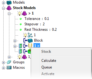

Right-click a Stock Model tool to display the menu.
Stock — The name of this menu.
Calculate — Select to calculate the stock model state.
Queue — Select to check all parameters used to calculate the stock model are acceptable, add the stock model to the calculation queue and closes the dialog. The stock model is calculated in the background when PowerMill is idle.
Activate — Select to display the stock model of the active state. For calculated stock model, this displays the stock model after this state is applied.
If you activate the Block state this displays the stock model of the block.
Similarly, if you activate the ModelAreaClearance toolpath state this displays the stock model of the toolpath.
Settings — Select to display the Stock Model Tool State dialog.
Remove — Select to remove the tool state from the stock model. If it is a calculated stock model, removing a state invalidates all subsequent stock model states.

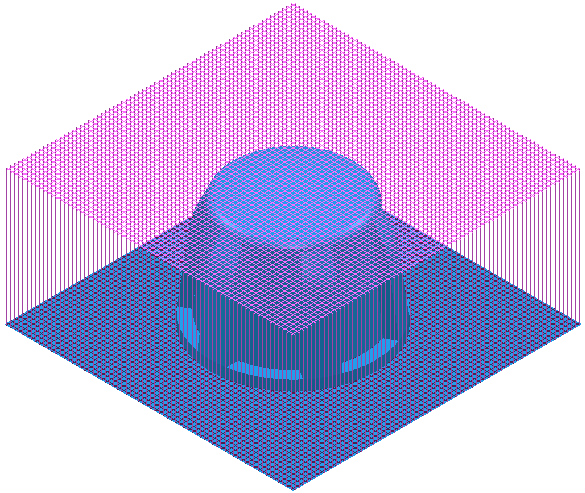

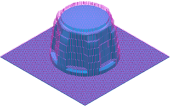

Remove Calculation — Select to remove the calculation for the active stock model state. This invalidates all subsequent stock model states.
Converts this:
to this:
If you remove the calculation of every state (you can do this by just removing the calculation of the block), then you are free to edit the stock model parameters (for example, tolerance, stepover, or workplane ). In this way, you can generate a stock model at different tolerances without having to reapply the toolpaths.
