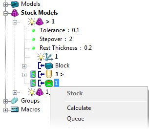

Right-click a Stock Model toolpath to display the menu.
Stock — The name of this menu.
Calculate — Select to calculate the stock model state.
Queue — Select to check all parameters used to calculate the stock model are acceptable, add the stock model to the calculation queue and closes the dialog. The stock model is calculated in the background when PowerMill is idle.
