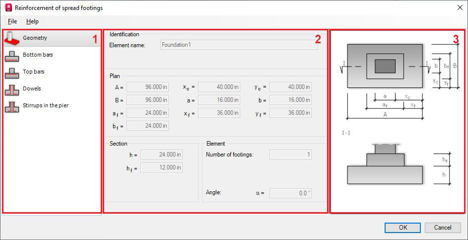

The dialog for generation of spread footing reinforcement has 3 main parts:
  1. On the left are options for selecting a component used to define spread footing reinforcement:
  2. In the center, you can define parameters of the spread footing and reinforcement (determined by a selected component).
  3. On the right is a graphical view of a defined spread footing and the generated footing reinforcement.
In the lower part of the dialog box, two options are available:
