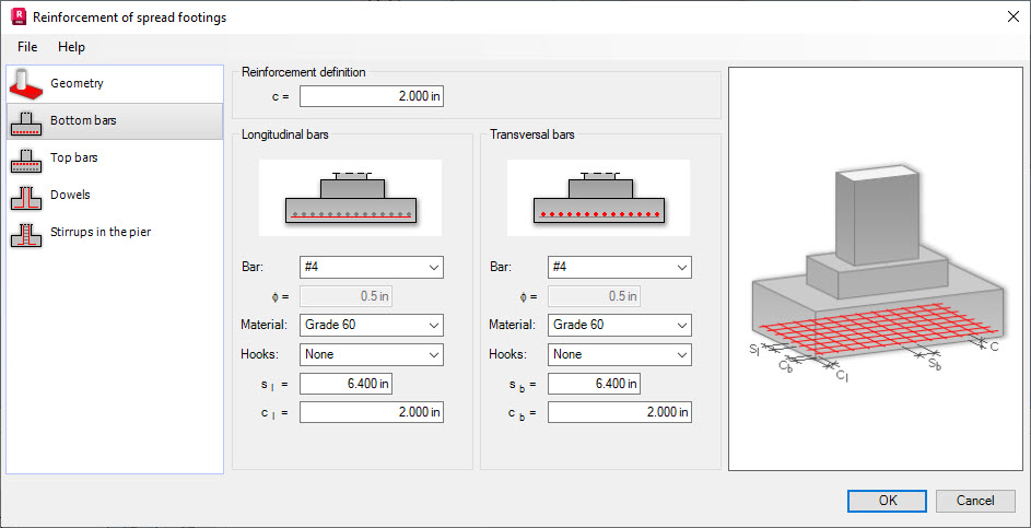

Bottom reinforcement
There are several parameters of bottom reinforcement defined in the Reinforcement of spread footing dialog:
  • Cover value c
  • Longitudinal bars
    • Steel grade (family)
    • Diameter and material of bars
    • Hooks
    • Bar spacing (s)
  • Transversal bars
    • Hooks
    • Bar spacing (s)
Parameters of hooks and bars are loaded from families defined in Revit. A bar diameter and material are associated with a selected steel grade (family).
