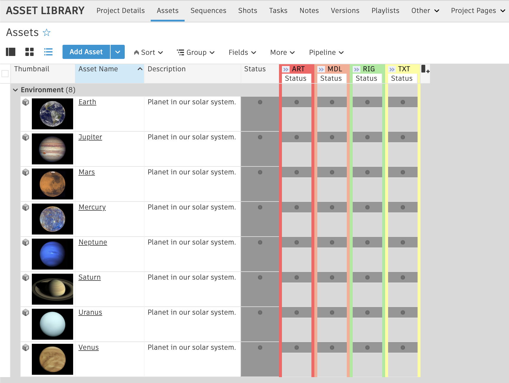

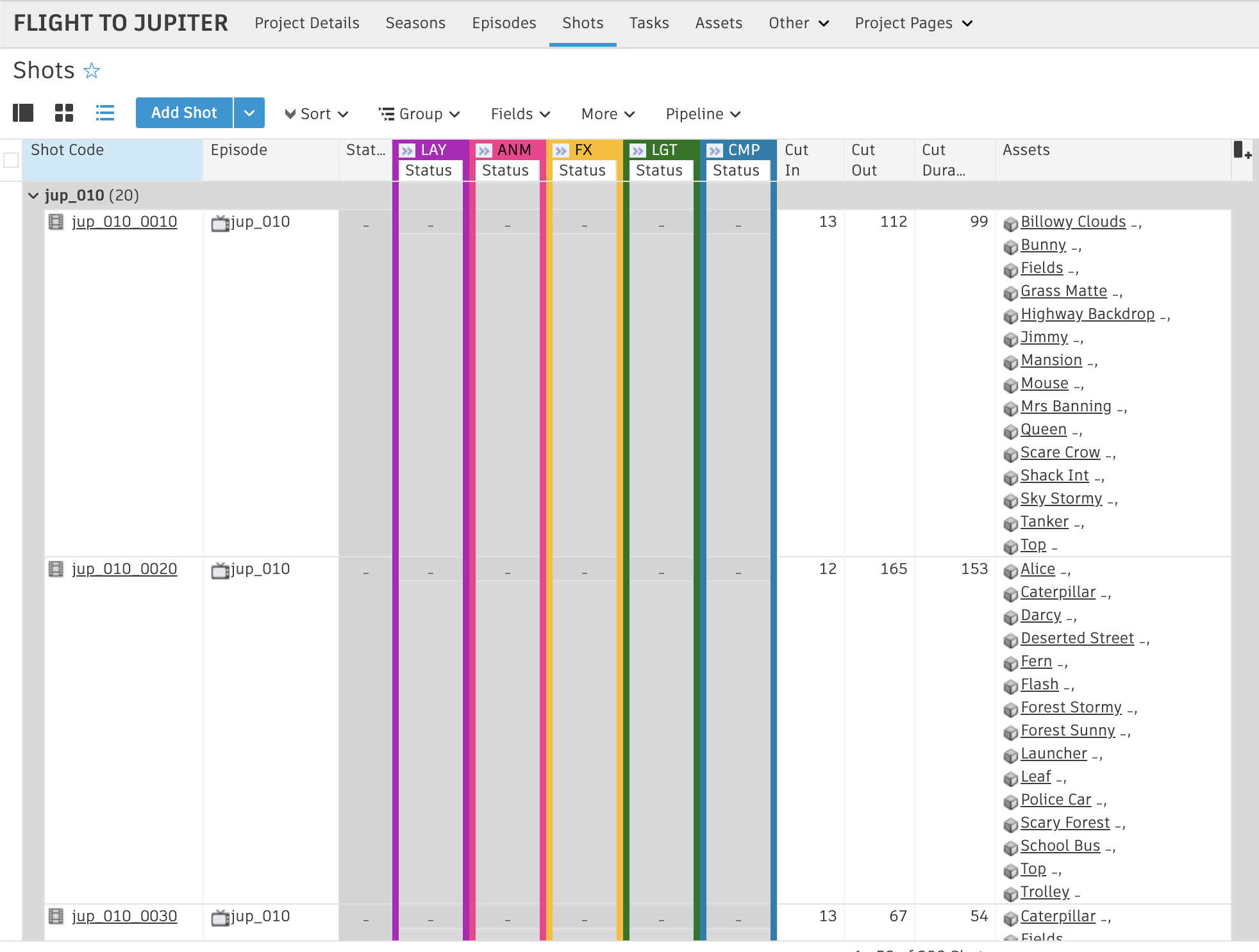

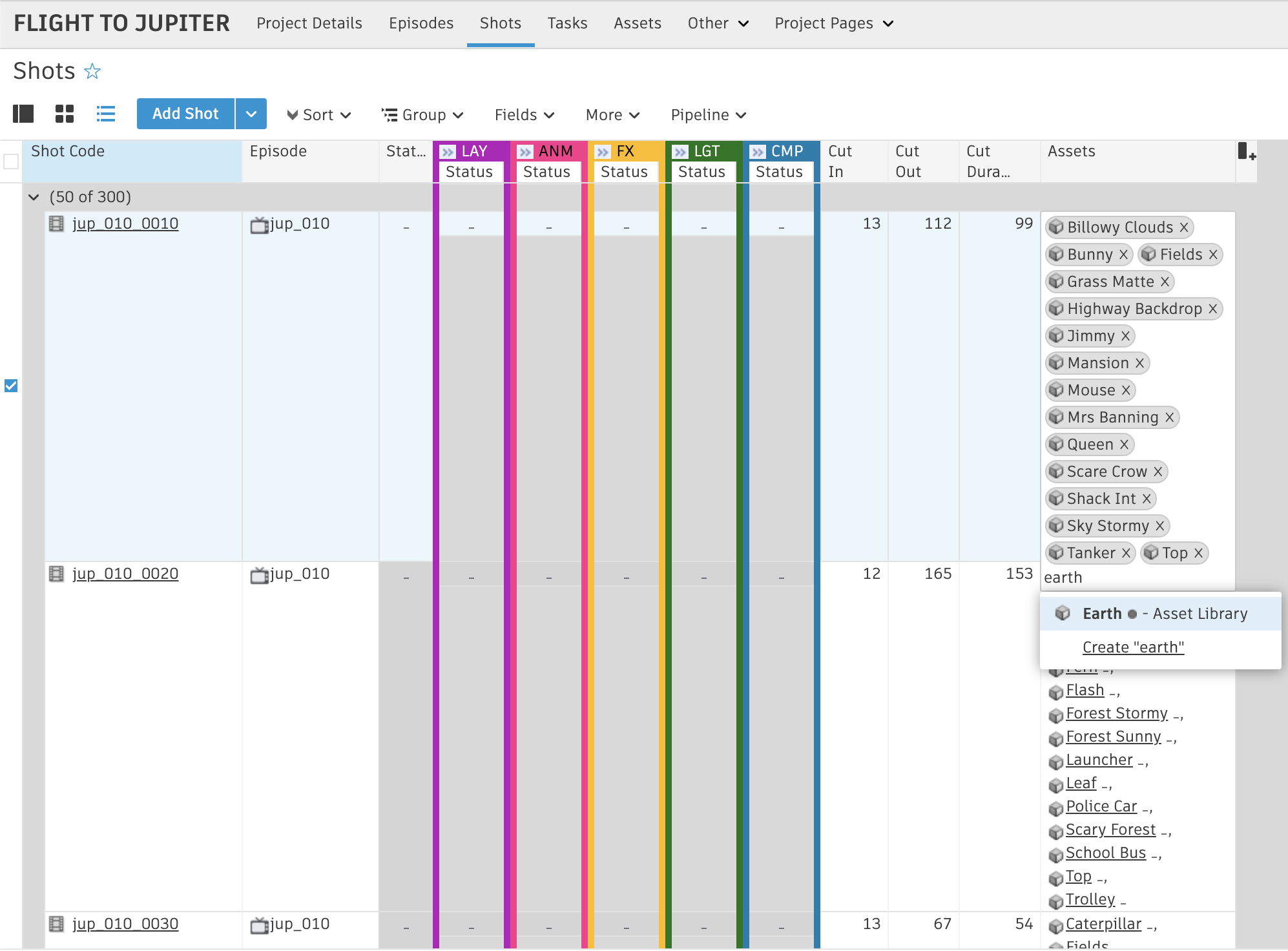

Reusing Assets by linking them to Shots
Here are the steps for linking Assets to Shots across Projects:

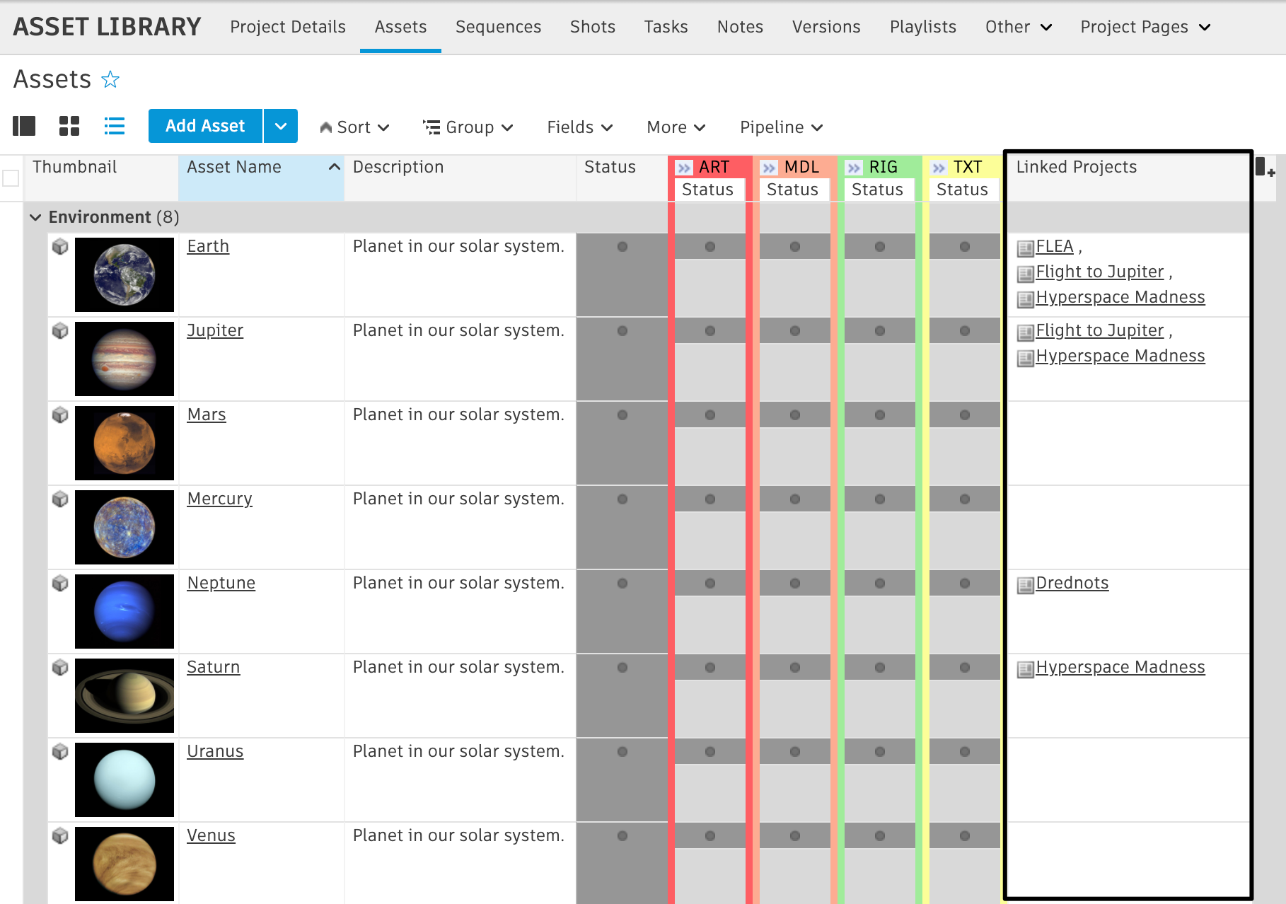

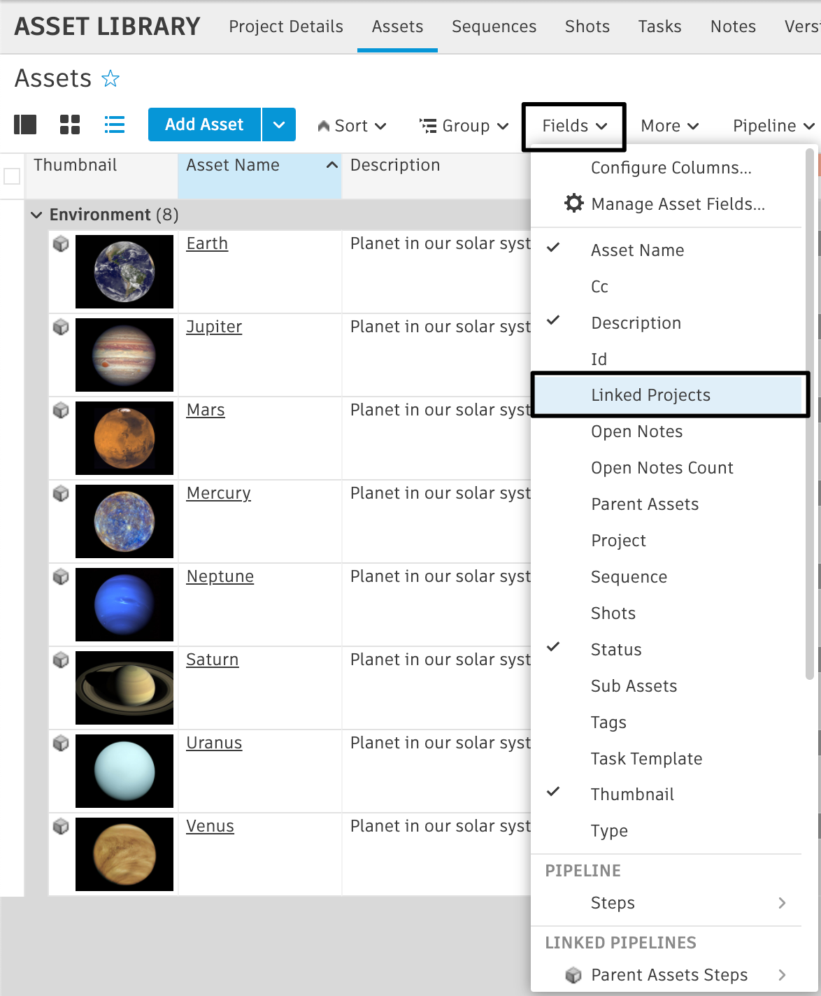

From the source Project that has the original Asset (Project A), navigate to the Assets page.
Add the Linked Projects field to the page.

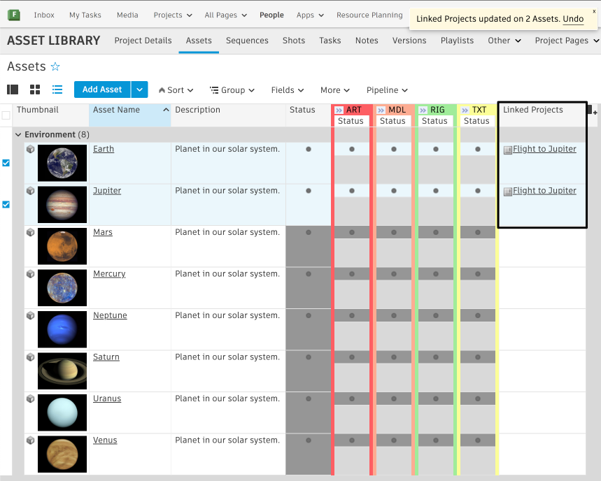

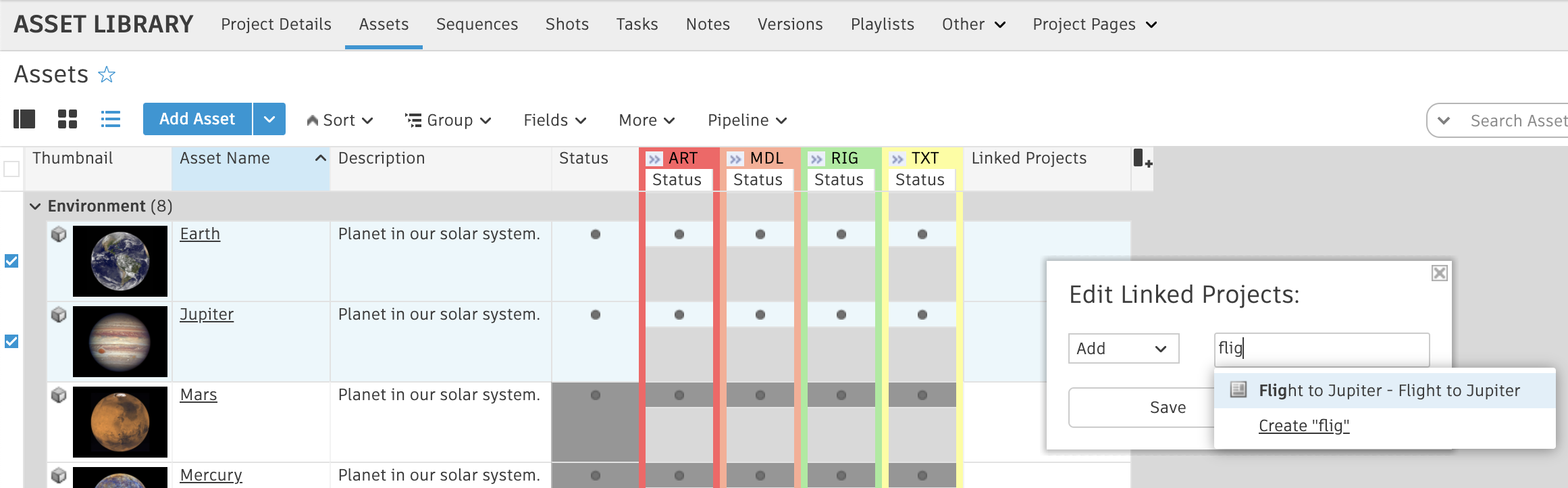

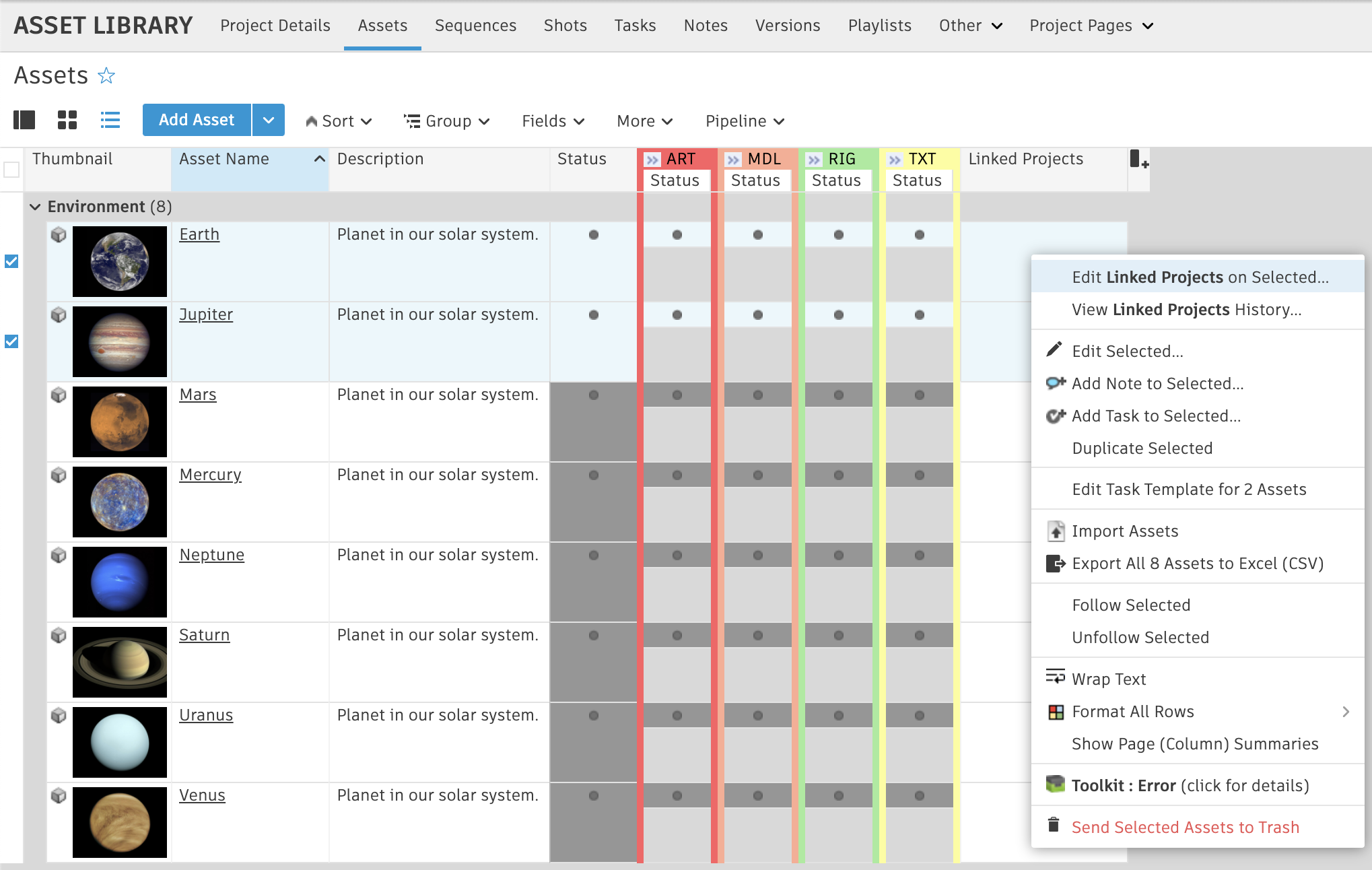

In the Linked Projects field, add the Project you would like to link the Asset to (Project B)—the Project must exist and autocomplete. This will make it available to use in the Project you are reusing it in. Tip: you can also bulk update this field.

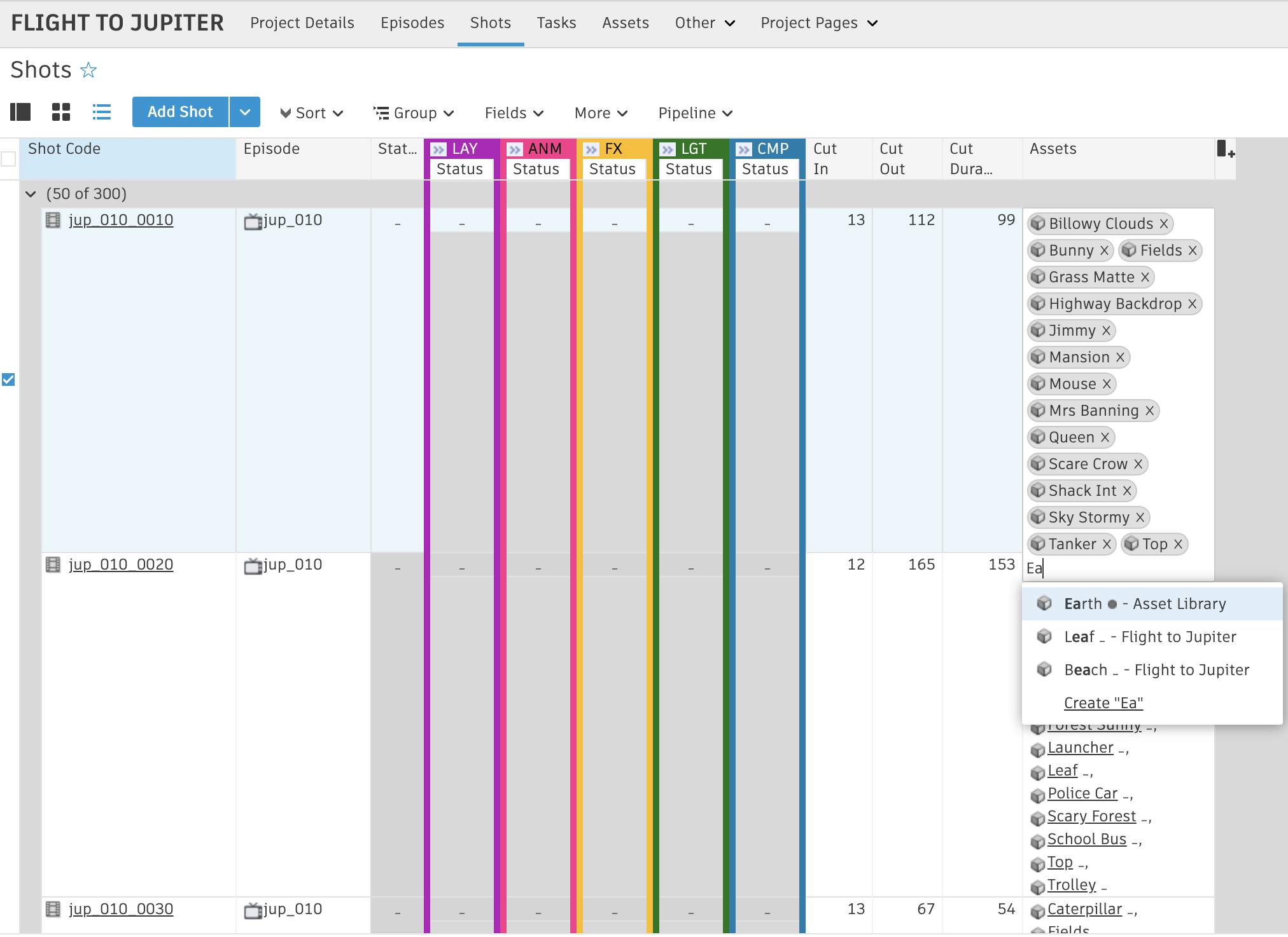

Navigate to the Project's Shot page that you would like to reuse the Asset in (Project B).
Now that the Assets have been shared from Project A (the source Project) to Project B, you can link these Assets to a Shot using the Assets field on Shots.

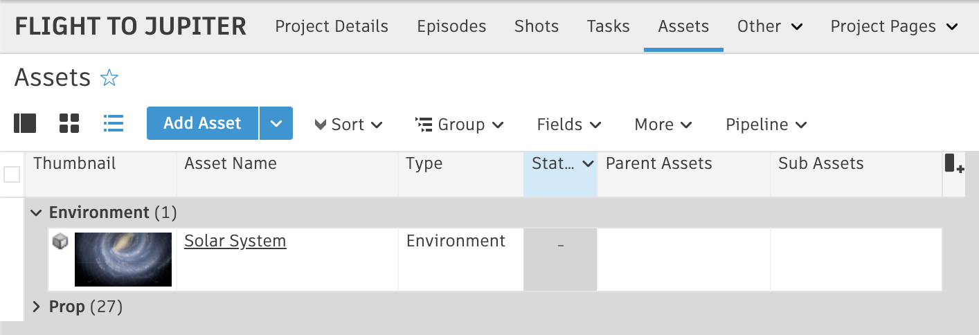

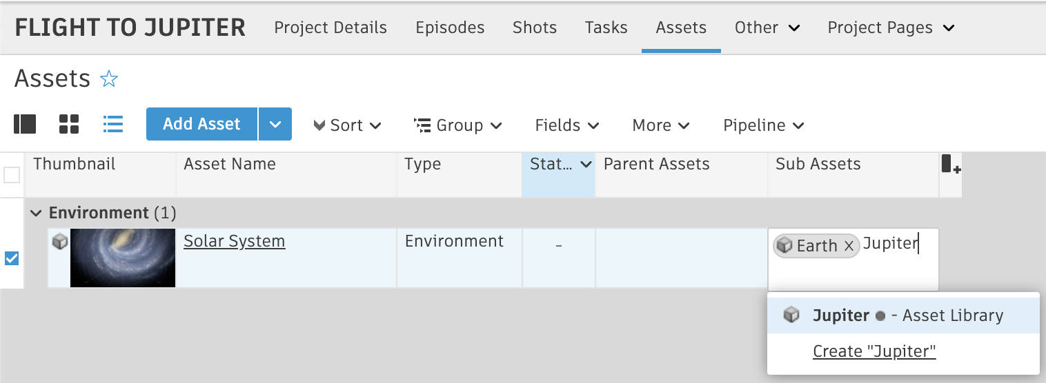

Reusing Assets by linking them to Parent and Sub Assets
Here are the steps for linking Assets across Projects using Parent Asset and Sub Assets:
From the source Project that has the original Asset (Project A), navigate to the Asset page.
In the Linked Projects field, add the Project you would like to link the Asset to (Project B)—the Project must exist and will autocomplete. This will make it available to use in the Project you are adding it to.
Navigate to Project B's Asset page.
Now that the Asset has been shared from source Project A to Project B, you can link this Asset in the Parent Asset or Sub Asset fields.

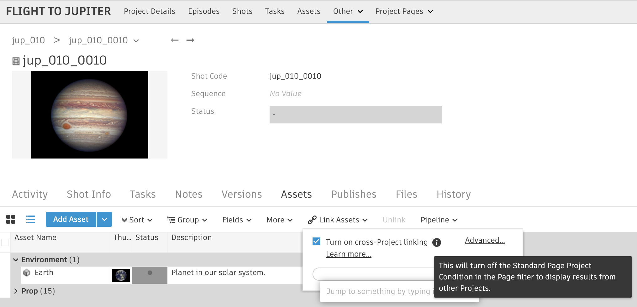

To see Assets linked to Shots across Projects, ensure that your detail page filters have this functionality turned on.
From a detail page, select Link Assets.

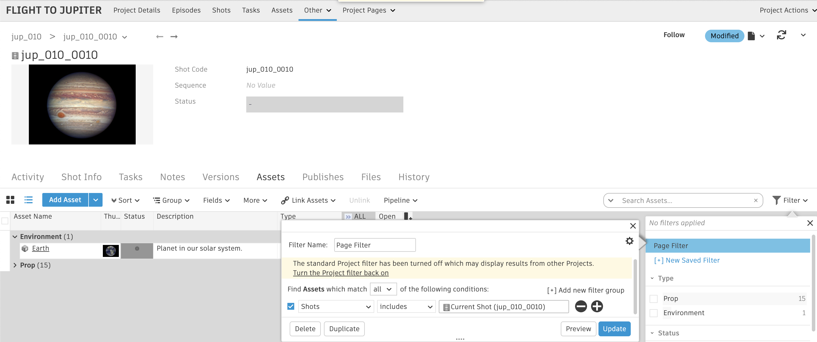

Select Turn on cross-Project linking.
This will update the page filter and the standard Project filter will be turned off.
Project filtering can be turned back on from the Page filter or the Link Assets option.
If a filter has not been applied to a Page, cross-Project linking is not available. In this case, the checkbox will be greyed out/turned off and a tooltip will appear upon hovering to explain why it is not possible to activate.

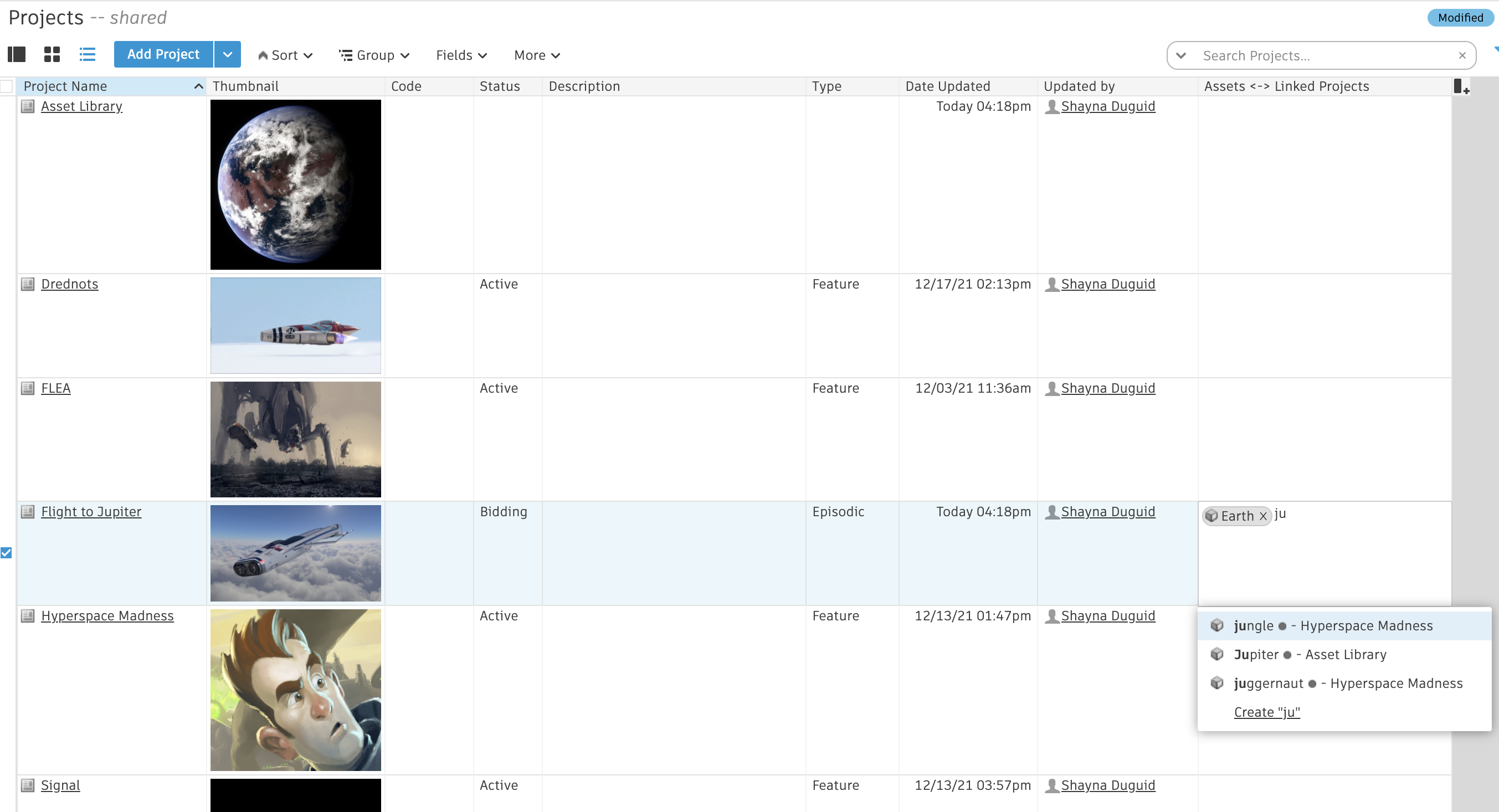

Linking Assets from the Projects Page
You can also link Assets from the Projects page with the Assets <-> Linked Projects field. This will allow you to reuse any Assets that are within the source Project.

Cross-Project Asset linking leverages autocomplete filtering. From the source Project, once you link an Asset to other Projects via the Linked Projects field on the Assets page, that Asset becomes available to link to any of the Projects specified in this field.
The Asset can be added to any entity/multi-entity Asset type field.

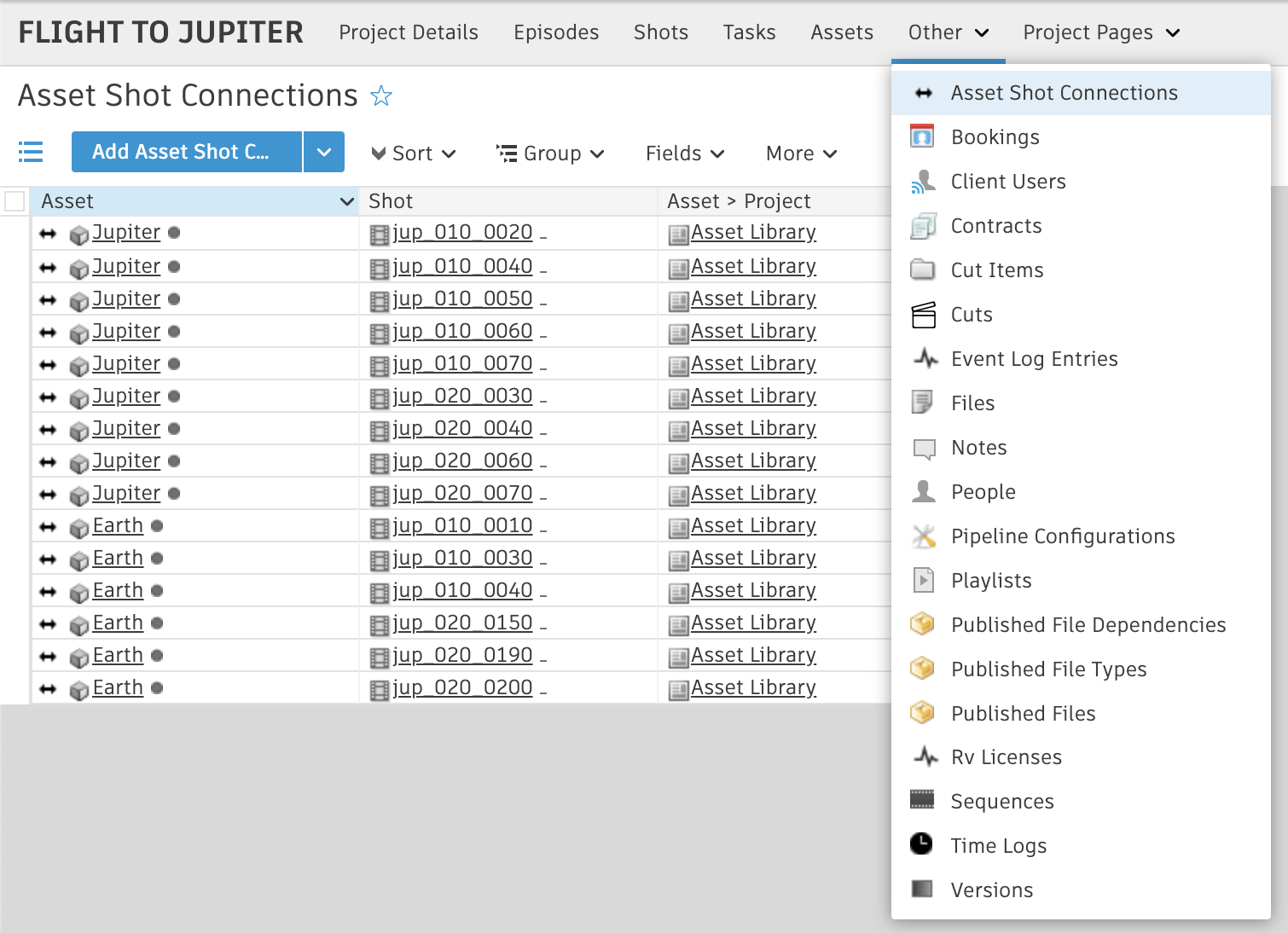

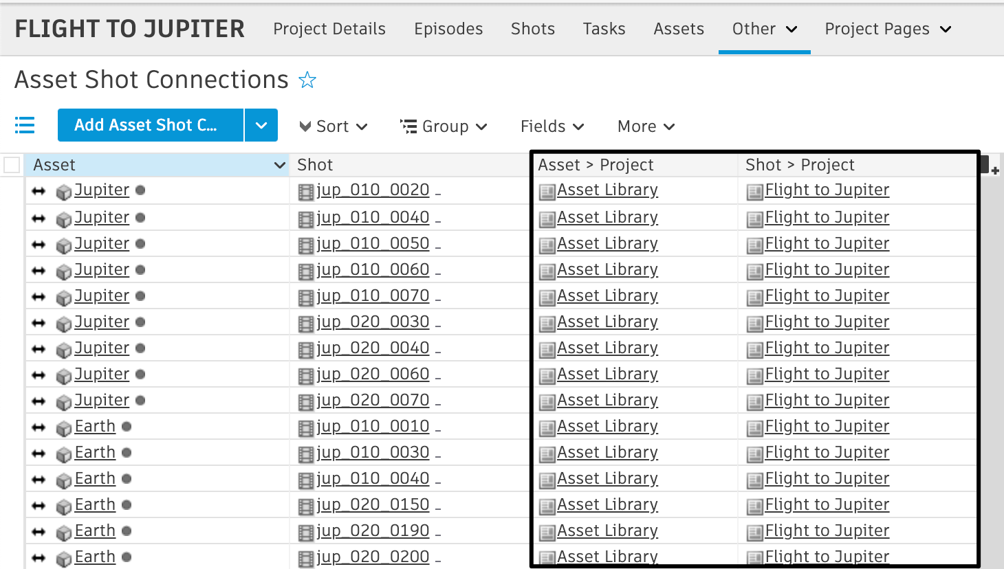

Using Connection Entities to track cross-Project Asset linking
You can leverage Asset Shot connection entities to track Assets being shared across Projects.

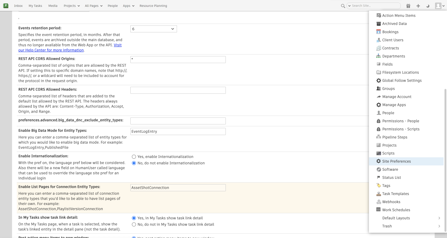

From Site Preferences under Advanced, Enable List Pages for Connection Entity Types and add AssetShotConnection.
Save this Site Preference.
From the Project navigation, select the Other dropdown and Asset Shot Connections.
From here, you can see which Assets are being reused in Shots.

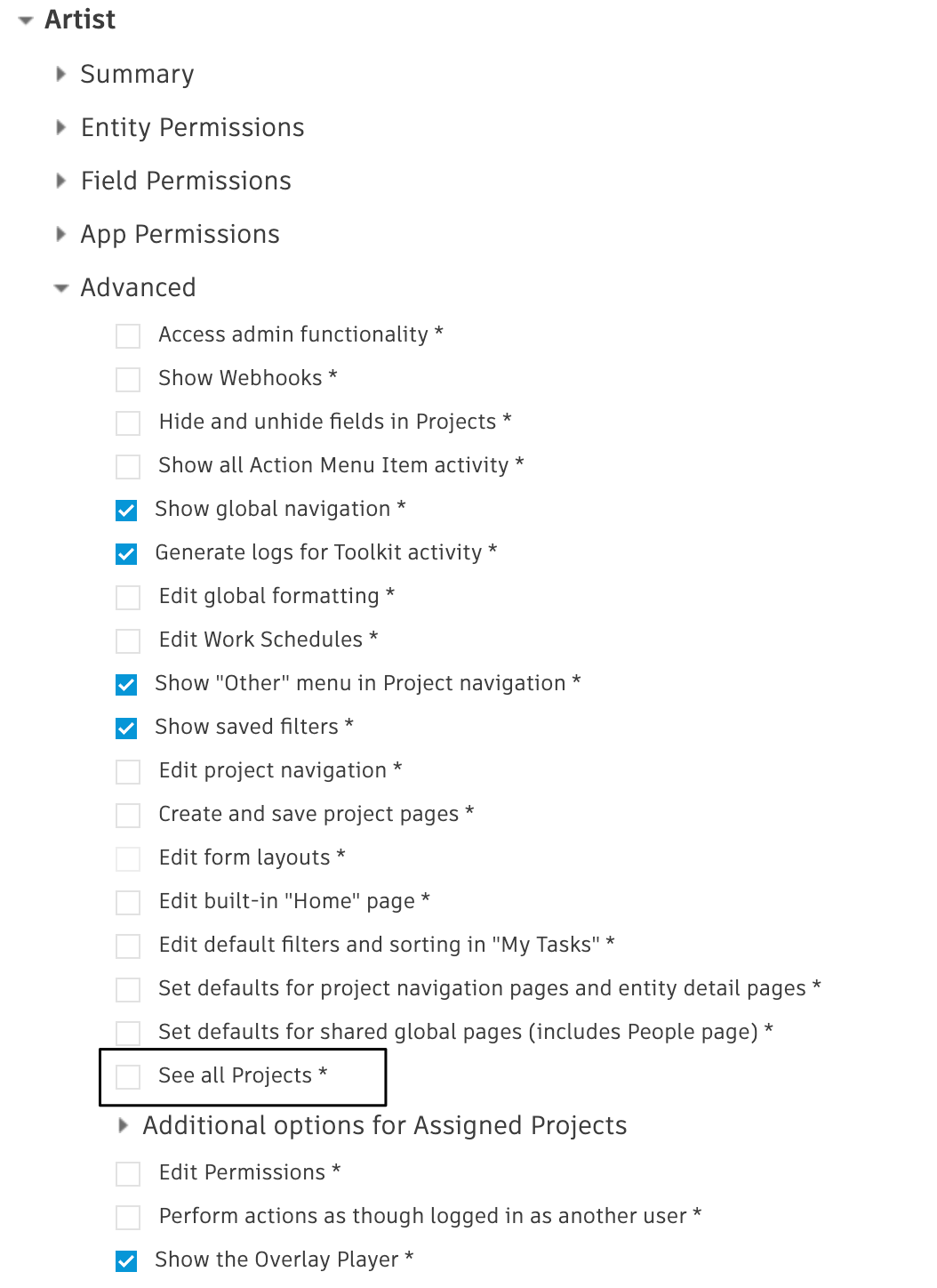

Permissions
In order for a user to see an Asset, they need to be assigned to the source project when the See all Projects option is not enabled.
