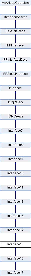

Extends Interface14 Client code should retrieve this interface using GetCOREInterface15.
Inheritance diagram for Interface15:Public Member Functions | |
