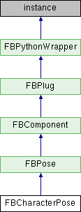

+ Inheritance diagram for FBCharacterPose:
