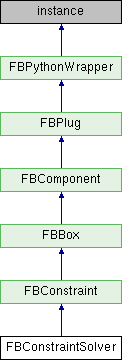

+ Inheritance diagram for FBConstraintSolver:
