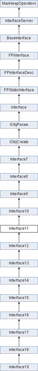

Extends Interface10 Client code should retrieve this interface using GetCOREInterface11.
 Inheritance diagram for Interface11:
 Inheritance diagram for Interface11:| Public Member Functions | |
