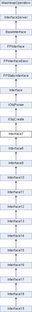

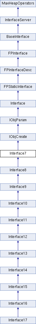

Interface7 Class Reference
#include <maxapi.h>
Class Description
This class extends Max's previous version of core interface (class Interface) "7" is the major version number of Max that exposes this interface.
Call GetCOREInterface7 to acquire a pointer to this interface.
+ Inheritance diagram for Interface7:
