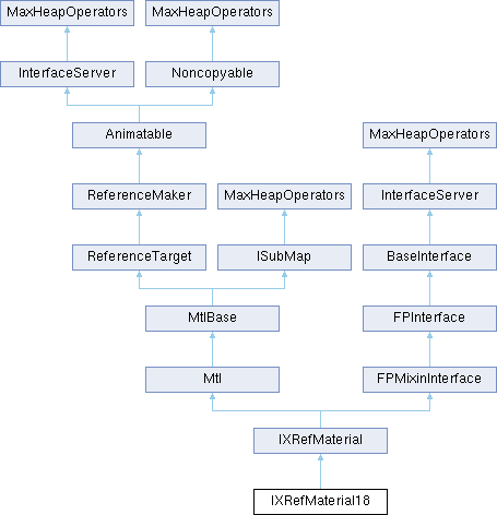

IXRefMaterial18 Class Referenceabstract
Class extends IXRefMaterial interface with override material feature. More...
#include <C:/adskgit/3dsmax/3dsmax/3dswin/src/maxsdk/include/XRef/iXrefMaterial.h>
Inheritance diagram for IXRefMaterial18:
