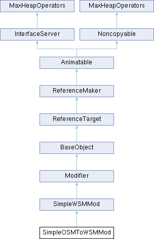

SimpleOSMToWSMMod Class Reference
#include <C:/adskgit/3dsmax/3dsmax/3dswin/src/maxsdk/include/simpmod.h>
Inheritance diagram for SimpleOSMToWSMMod:
