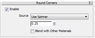

Interface
There are three controls for round corners:
- Enable
- When on, rounds off corners and straight edges at render time. Default=off.
- Source
- This drop-down list lets you choose between using a value or a map for the radius used to fillet the corners and edges.
- [Fillet Radius spinner]
Specifies the radius of the filleted corners and/or edges. Default=0.25.
- [Map button]
Click the button to apply a map to this parameter (in the Slate Material Editor, you can also wire the Round Corners Source socket). Mapping the Fillet Radius creates variations in the amount of corner rounding.
- Blend with Other Materials
- By default, the rounding effect happens only between surfaces of the same material, but if you turn this on the filleting is performed against any material. Default=off.
