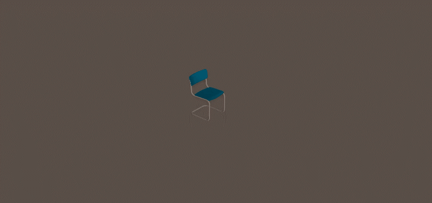

The Grid Distribution Method creates a uniform set of clones in a 1D, 2D, or 3D grid pattern. The following example uses the Grid Distribution method to create a set of chairs. See Create a set of chairs using the Array Modifier for a detailed workflow example.

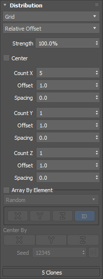

Layout method
Lets you select the way clones are arrayed in the viewport.
Note: The options that appear below the Layout method drop-down list update dynamically based on your selection.

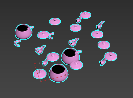

  • Random: Each element is randomly used as a potential clone. In the following example, a 5 (Count X) x 5 (Count Y) x 1 (Count Z) is used.
  • Tip: This option can be used to create a collection of objects, like books in a bookcase or bricks in a wall.

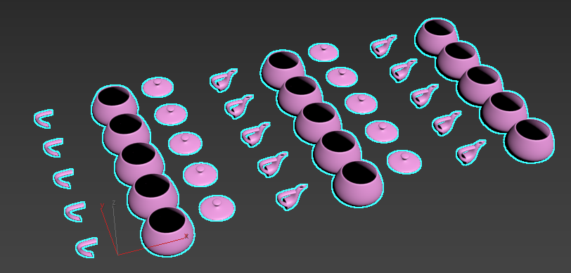

  • Ordered: Elements are arranged in sequential order based on a selected orientation (X, Y, Z) or Clone IDs. In the following example, the elements of the teapot appear in sequential order along the X-axis, repeating after the array has cycled through all four elements. A 10 (Count X) x 5 (Count Y) x 1 (Count Z) grid is used.

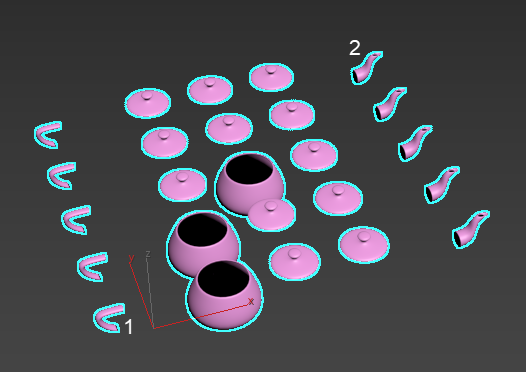

  • First Middle Last: The first and last clone remain the same, and the remaining clones are arranged randomly. In the following example element 1 is the first clone and element 2 is the last clone. The other clones in these rows along the X-axis. A 5 (Count X) x 5 (Count Y) x 1 (Count Z) is used.
    Note: A First Middle Last arrangement requires at least four elements in the object to provide the expected result.
