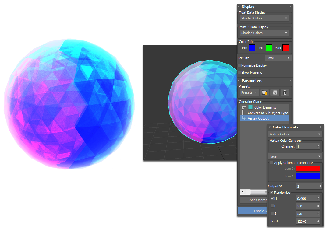

The operators in this group output the data back to the mesh. On the Parameters rollout, click Add Operator to select an output operator from the list.
The Color Elements operator randomly coloring each face of a GeoSphere while driving the material's base and transparency using the vertex color output.
