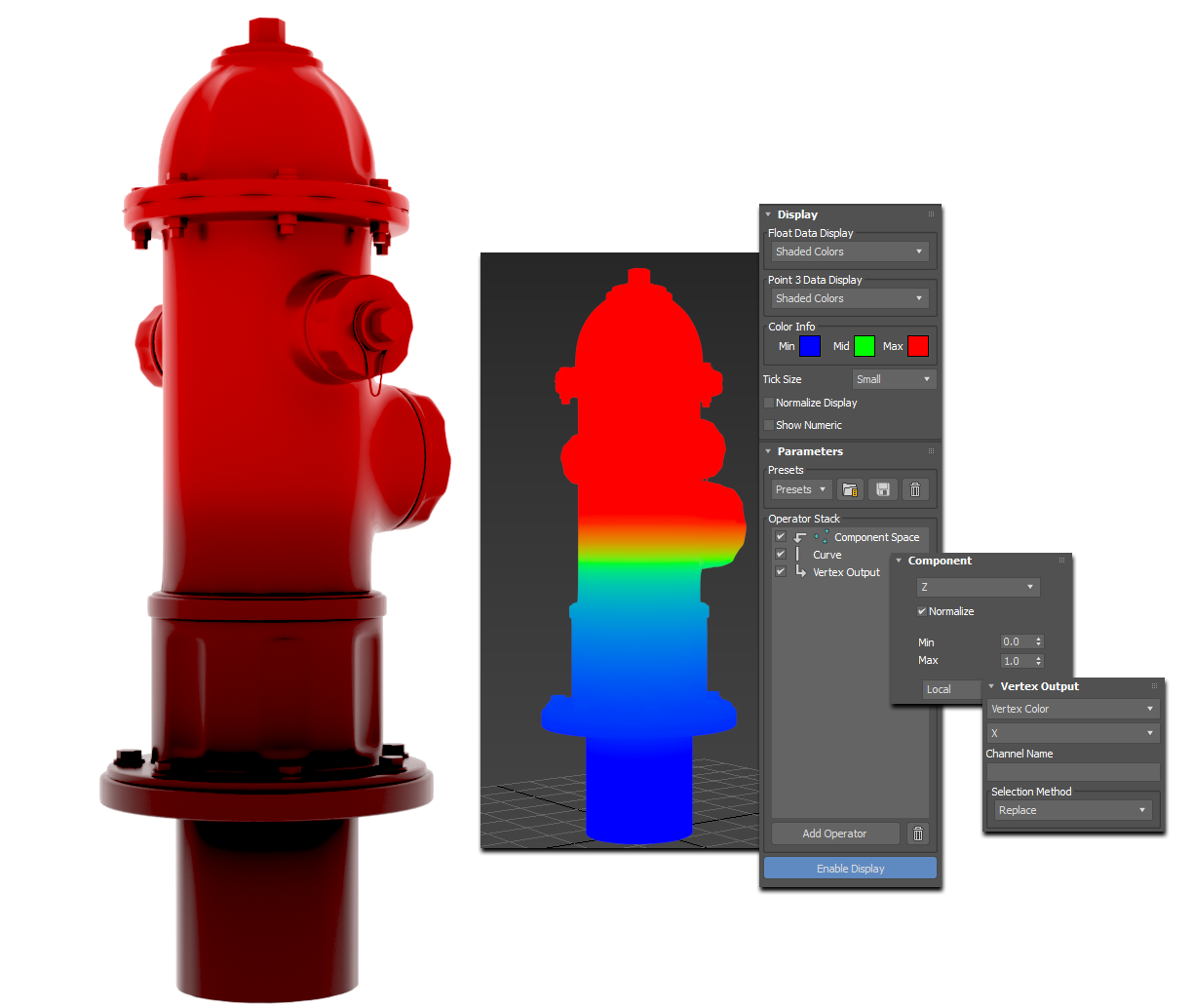

The operators in this group query data and create a channel to flow down the stack. In the Parameters rollout, click Add Operator to select an Input operator from the list.
Using the Component Space operator to color vertices according to their Z position, and the Curve operator to refine the result. The resulting vertex color data is then used to mix two colors for the material.
