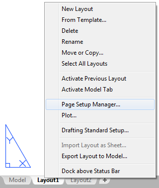

  1. Right-click on the Layout tab and select Page Setup Manager from the contextual menu:

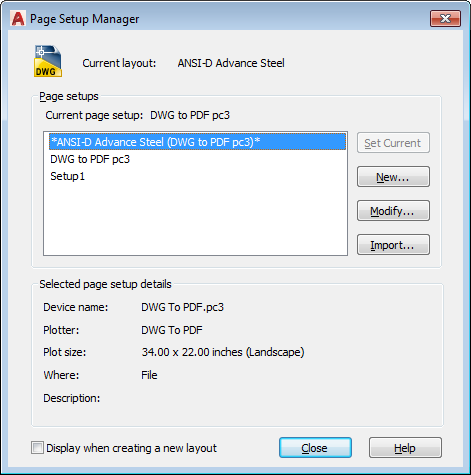

  2. Add or edit the existing page settings and set it as current (which will mark it with an asterisk):
  3. Click the Modify... button to open the Page Setup dialog.

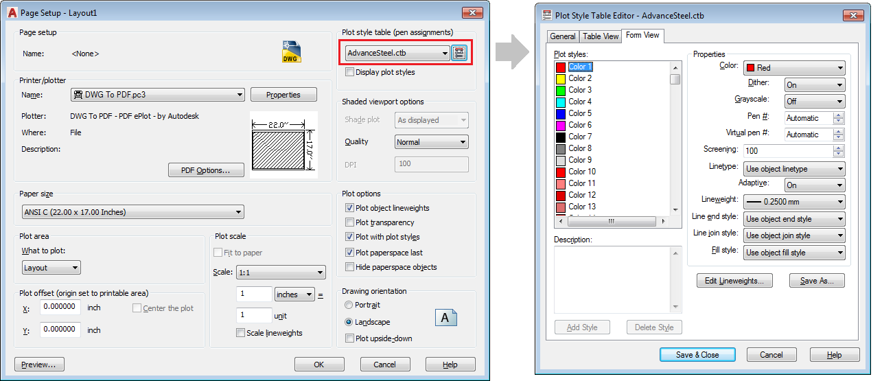

  4. In the Page Setup dialog, set the paper size and the plot area.
  5. Set up the CTB used for plotting. The CTB allows you to control the lineweight through colors. Advance Steel controls the color used to detail each distinct object, but not the line weight. You can control this for printing, using the CTB which maps colors to lineweights:
