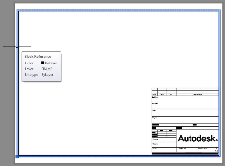

The prototype frame is defined using a specific block that contains lines and text to define the appearance of the frame.
Edit the page frame
  1. Select the existing frame and use the _Explode command.
  2. You can edit with the AutoCAD commands: Edit/Create Lines, Add Text and Polylines.
Redefine the page frame
  1. Use the _Block command. The Block Definition dialog appears.
  2. In the Block Definition dialog, select HYPERSTEELPAGEFRAME from the Name drop-down list.
  3. Leave the Base point coordinates at 0,0,0.
  4. Use the (Select objects) button to select the objects that define the page frame.
  5. Make sure the Block unit settings match the prototype units. For example, set the block unit settings to inches if the prototype is set to Imperial.
  6. Click OK. When prompted that the block definition was changed, click Redefine.
  7. Click OK to close the Edit Attributes dialog.
  8. Save the prototype.
