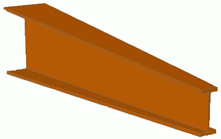

Tapered welded beams with varying cross section along their system line can be created from plates or flats welded together. The beams are handled as a single section.
Create tapered welded beams
You can create welded sections like simple sections, by entering a start point and an end point according to the current coordinate system. The current user coordinate system (UCS) determines the position of the sections main axes: the beam web runs in the Z direction of the UCS - the top of the section is in the Z direction.
To create tapered welded beams, use the Welded beams flyout on the Beams panel of the Objects tab.
Additionally, you can create custom welded sections and store them in a library. Using the properties dialog box, you can control the section class and the section of each individual element in the welded beam.
Tapered beams can be created in different shapes:
- With one segment.
- With several segments (up to five).
- Flanges can be made out of plates or flats (bottom and top flanges can be the same or different).
