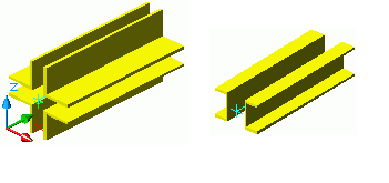

Two or four sections are created at a system line as a combined section. The sections are handled as a single section, so any action will affect all composing sections.
Create compound sections
You can create compound sections like simple sections, by entering a start point and an end point according to the current coordinate system. The current user coordinate system (UCS) determines the position of the section's main axes: the beam web runs in the Z direction of the UCS - the top of the section is in the Z direction.
