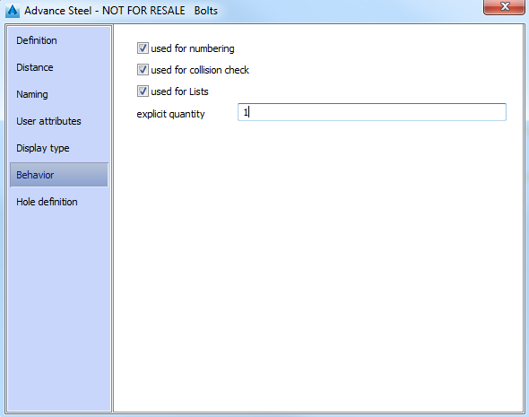

On this tab of the properties dialog box, you can select the bolt behavior at collision check and numbering.
Option | Description |
Used for numbering | The bolt is used for numbering. |
Used for collision check | The bolt is used for the collision check. |
Used for lists | The bolt is used in the bill of material. |
Explicit quantity | Defines the amount in the bill of material. Therefore, it is possible to create one part in the model and multiple parts in the BOM. |
