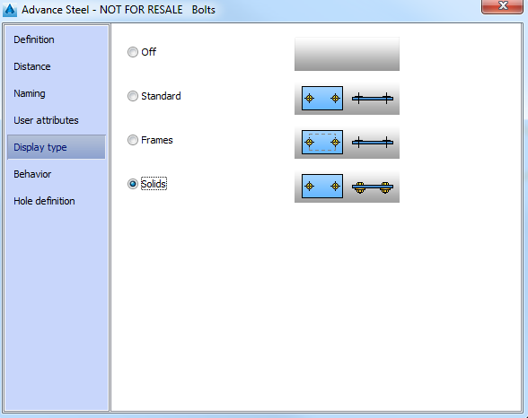

Bolts Dialog: Display Type Tab
On this tab of the properties dialog box, you can select the way the bolts display in the model.
Display type Bolts Description
Off Only the holes are displayed.
Standard Section edges and processing objects.
Frames The definition frame is displayed.
Solids The bolt and nut solids are represented.
