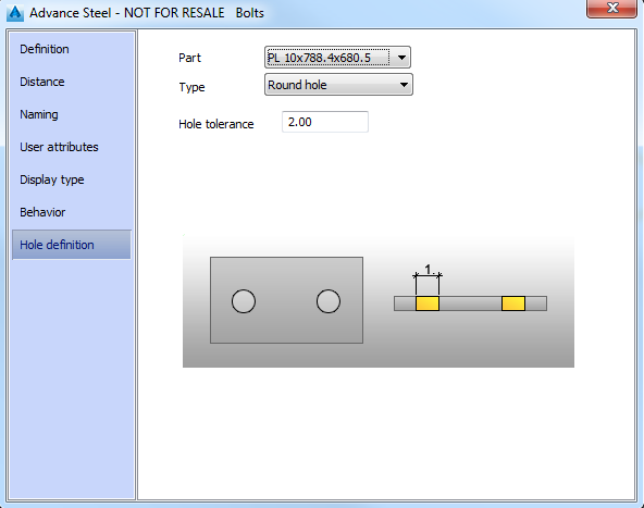

Bolts Dialog: Hole Definition Tab
On this tab of the properties dialog box, you can select the type of hole created for the bolts. The parameters change according to the selected hole type.
Option Description
Part Displays the list of the elements involved in the connection. The active element is marked. For each element, a different hole type can be selected.
Type Select the hole type for the selected element. The dialog box displays the parameters for the selected hole type.
Hole tolerance Defines the hole tolerance.
