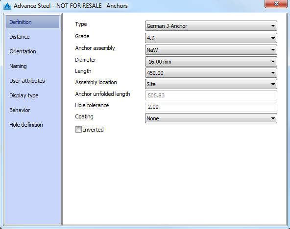

Anchors Dialog: Definition Tab
All anchors have default properties that you can change in the properties dialog box, which automatically opens after you create an anchor pattern.
Option Description
Type Selects the anchor standard from the list.
Grade Selects the steel grade from the list.
Anchor assembly Selects the anchor assembly for the connection.
Diameter Selects the anchor diameter from the list.
Anchor length Displays the length of the anchors used in the connection.
Assembly location Selects the anchor assembly location (site, site drill, shop).
Hole tolerance Defines the hole tolerance. This value increases the hole diameter.
Coating Selects the coating from the list.
Inverted check box Changes the direction of the anchor axis.
