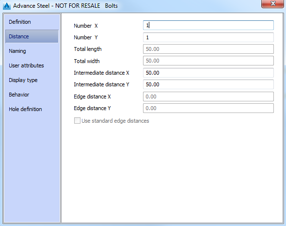

Bolts Dialog: Distance Tab
On this tab of the properties dialog box, you can modify the size of the bolt group defined by two diagonal points.
Note: The intermediate distance and the edge distance are related since the bolt pattern width and length do not change. One value is calculated automatically when the other one is set.
Option Description
Number X Defines the number of bolts in the X direction.
Number Y Defines the number of bolts in the Y direction.
Total length Defines the length of the bolt pattern (in the X direction).
Total width Defines the width of the bolt pattern (in the Y direction).
Intermediate distance X Defines the distance between bolts along the X-axis.
Intermediate distance Y Defines the distance between bolts along the Y-axis.
Edge distance X Defines the outer bolt line distance to the bolt pattern edge in the X direction.
Edge distance Y Defines the outer bolt line distance to the bolt pattern edge in the Y direction.
Use standard edge distances check box Optionally, you can use the standard edge distances. The values are set according to the selected bolt type.
