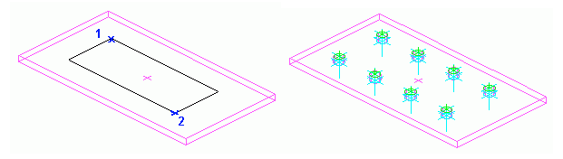

Create a Rectangular Pattern Using Two Points
Insert bolts, anchors, holes, or shear studs in a rectangle defined by the diagonal corner points.
You can set an edge distance to the rectangular contour.

Create a rectangular bolt pattern using two diagonal points
  1. Set a suitable user coordinate system.
  2. On the Objects tab Switch panel, switch to (Bolts).
  3. Select a suitable display type. if necessary. For example, for beams, if a bolt pattern is inserted on the gauge line, use the Exact display type.
  4. On the Objects tab Connection objects panel, click (Rectangular, 2 points).
  5. Select the objects to connect and press <Enter>.
  6. Specify the first corner point.
  7. Define the diagonal corner point.
  • The bolt pattern is created.
Create a rectangular hole or shear stud pattern using two diagonal points
  2. On the Objects tab Switch panel, switch to (Holes) or (Shear Studs).
  3. Select a suitable display type if necessary. For example, for beams, if the pattern is inserted on the gauge line, use the Exact display type.
  5. Select a beam or plate and press Enter.
  • The pattern is created.
