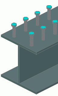

You can insert shear studs in the model the same way as bolts, having the same options for displaying and editing. Holes are dependent on their reference object regarding their representation type.
Note: In the center of the shear stud pattern (intersecting point of the rectangle's diagonals) a weld point is inserted. It connects the studs to a beam or a plate and must not be deleted.
Bolt, hole, anchor and shear stud patterns have a Behavior property tab that describes if and how the element numbers are part of the structured BOM.
Bolts and shear studs are created in the color cyan (by default) as individual Advance Steel elements and can be modified as needed. Changes in the bolt pattern will also automatically update the holes.
