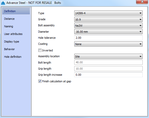

All bolts have default properties that you can change in the properties dialog box, which automatically opens after you create a bolt pattern.
Option Description
Type Selects the bolt standard from the list.
Diameter Selects the bolt diameter from the list.
Grade Selects the steel grade from the list.
Hole tolerance Sets the hole tolerance. This value increases the hole diameter.
Bolt assembly Selects the bolt assembly for the connection. For example: Mu2S = nut and 2 washers; MuKS = nut and grooved pulley.
Coating Selects the coating from the list.
Inverted check box Changes the direction of the bolt axis.
Assembly location Selects the bolt assembly location (site, site drill, shop).
Bolt length Displays the length of the bolts used in the connection.
Grip length Displays the grip length of the connection thickness for the connected parts.
Grip length increase Defines the value added to the calculated grip length, to make sure the bolts are not too short due to production inaccuracy.
Finish calculation at gap check box Optionally, the calculation of the bolt length can finish at the gap (if a gap exists between the objects to connect).
