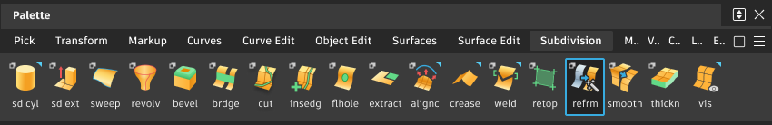

Access the tool from the Subdivision Palette:
Subdiv Reform settings

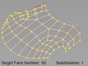

Target Face Number
Sets the number of subdivision faces generated in the output object. The higher the value, the higher the resolution of the subdivision model. This value is an approximate target value. For example, a value of 50 results in a subdivision object with between 40 and 60 quad faces.

Subdivisions
Use this option to control the overall resolution of the output subdivision object. When Subdivision is increased by a value of 1, Alias divides each face into four faces. If the Target Face Number is set to 50, increasing Subdivision from a value of 1 to 2 increases the number of subdivision faces to 200.
The higher the Subdivision value, the closer the output subdivision object resembles the shape of the source mesh.

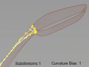

Curvature Bias
Use this setting to increase the distribution of CVs to areas of higher curvature, which can improve the overall shape of the resulting subdivision model. At lower values, the resulting CV layout is more uniform. Increasing this value changes the layout CV to one that distributes a higher number of CVs to areas with more curvature. Typically, higher values take longer to compute.
