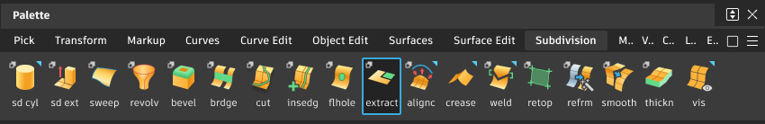

Access the tool from the Subdivision Palette:
Extract subdivision faces
