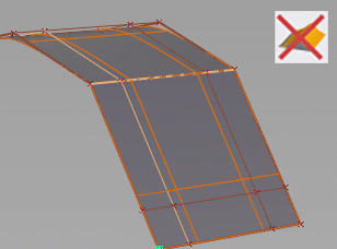

Uncrease Subdiv Edge
Removes G0 creases created by the Crease Subdivision Edge tool.

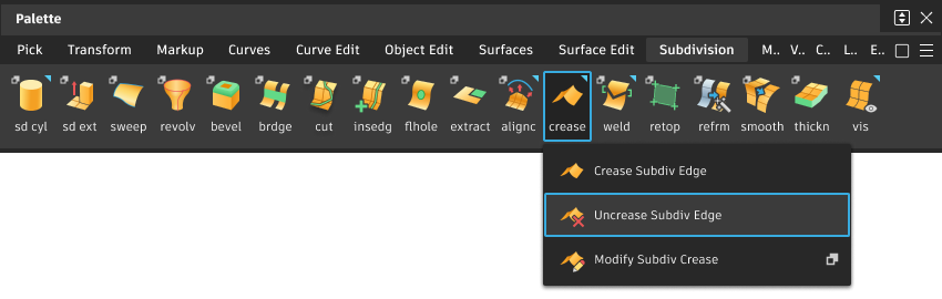

Access the tool from the Subdivision Palette:

Uncrease a subdivision edge
Choose a picking method for selecting the edges you want to uncrease.
Select one or more edges that have already been creased.
Select the Uncrease Subdiv Edge tool.
The creases are removed from the edges that you selected.
