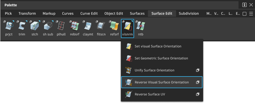

Access this tool from the Surface Edit tool palette:

Select the tool.
Click a surface for which you want to reverse the orientation.
