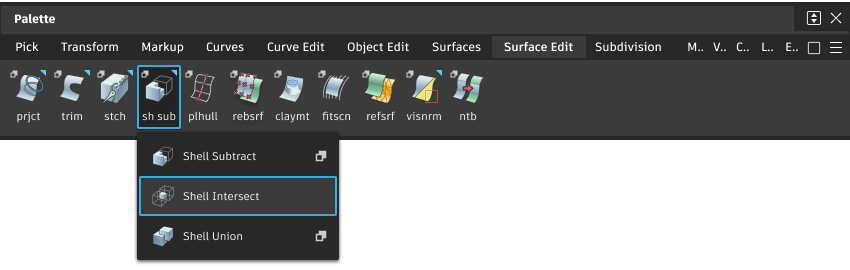

Shell Intersect
Keeps the intersecting volume of two shells and discard the rest.
Access this tool from the Surface Edit tool palette:
Shell Intersect Options
