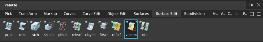

Set Visual Surface Orientation
Orients surfaces toward or away from the camera without affecting its U and V directions. Left-click a surface to orient it towards the camera. Middle-click the surface to orient it away from the camera.
Surfaces facing toward the camera are shaded gray, surfaces facing away from the camera are shaded yellow.
Access this tool from the Surface Edit tool palette:
