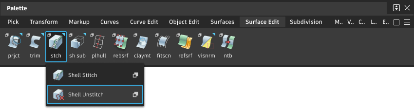

Converts a shell object back to normal surfaces.
Access this tool from the Surface Edit tool palette:

Shell Unstitch workflow
- Pick the shell object.
- Slect the Shell Unstitch tool
