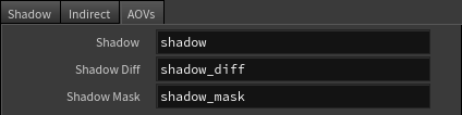

Per light group shadow mattes. More information about light groups can be found here.
AOVs
A list of available AOVs available for the Shadow Matte shader. Each option creates a separate AOV render pass for that component.
Note:
Note that the AOV must also be enabled in the Render Output.
