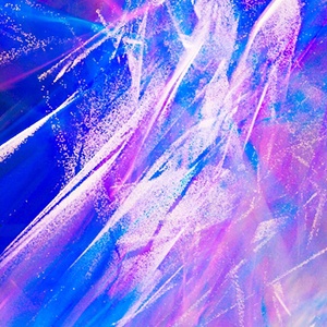

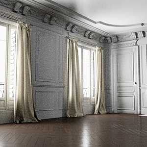

Arnold has the capability of adapting the sampling rate of each pixel when Adaptive Sampling is enabled, allowing it to dedicate a greater number of camera samples (and thus also a greater amount of render time) to the pixels that show a greater variation in their sample values. When used, all pixels will receive a sampling rate of at least Camera (AA) samples, but no more than AA Samples Max. The adaptive sampler's sensitivity to noise may be controlled through the Adaptive Threshold render option, where lower threshold values will apply higher sampling rates to a greater number of pixels.

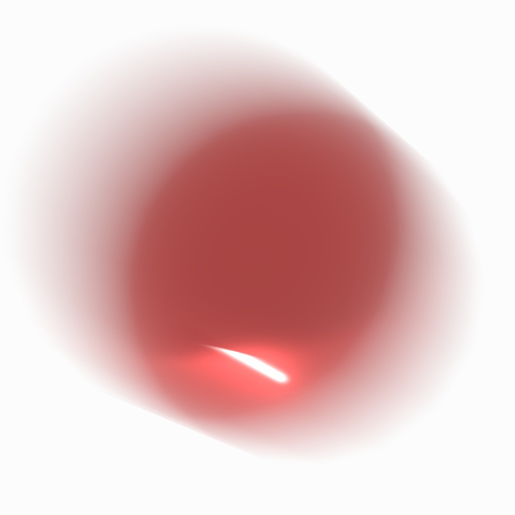

Adaptive sampling is good for situations where small areas of the image have high levels of noise that require an impractical number of samples to clear up. For example, scenes with bright, motion-blurred speculars, DOF, buzzing rim lights, or scenes with the hair shader.
| Camera (AA): 3 (4 seconds). | Camera (AA): 3. Max AA: 12 (1 minute). | Camera (AA): 12 (1 minute, 11 seconds). |

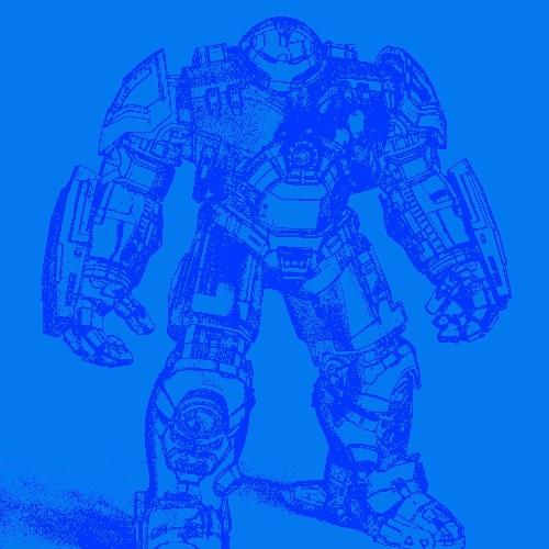

The AA_inv_density AOV can help to visualize the sample density with Adaptive Sampling. Use it with a Heatmap filter.
| adaptive threshold: 0.015 (default) | adaptive threshold: 0.1 |
aa_inv_density AOV with heatmap filter

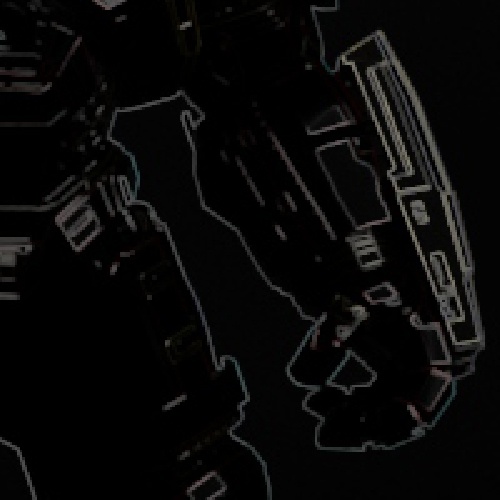

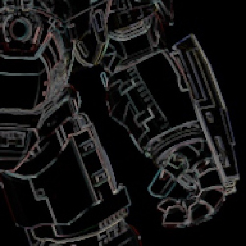

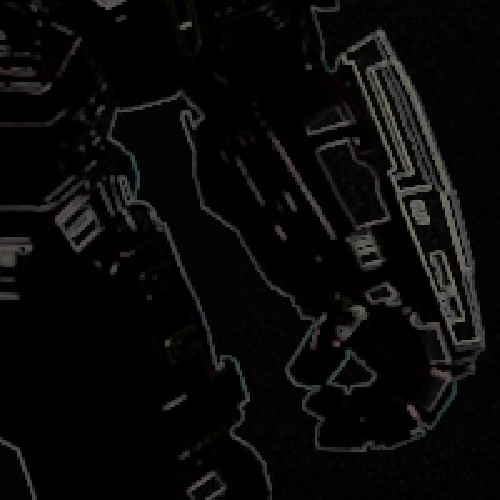

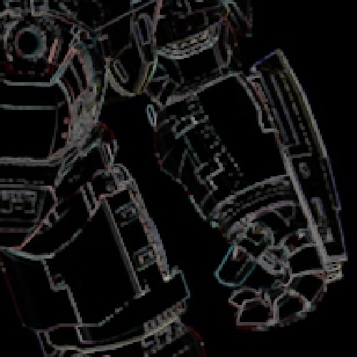

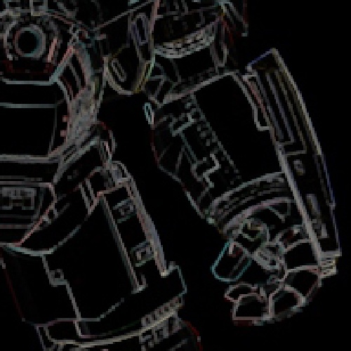

| 0 | 4 | 8 |
variance_filter showing effect of Max. Camera (AA)
