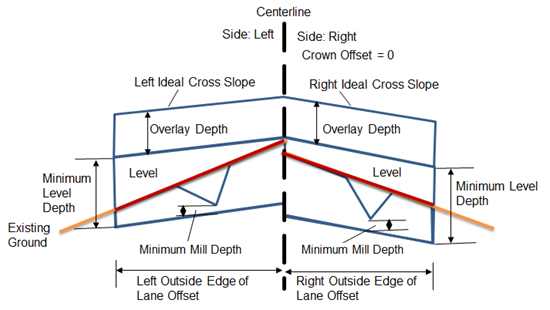

Behavior
This overlay layer assumes that flapping is applied within slope tolerance. Elevation at the crown will meet both sides of the roadway.

| Point, Link, or Shape | Code | Description |
| P1, | Crown | Crown point for top of overlay |
| P2, P3 | EOV | Edges of overlay for finished grade |
| P4 | Crown_Overlay | Crown point for bottom of overlay |
| P5, P6 | EOV_Overlay | Edges of bottom of overlay for left and right side of the road |
| P7 | Crown_Milling | Crown point for top of mill |
| P8, P9 | EOV_Milling | Edges of mill for right and left side of road |
| L1, L2 | Top, Pave | Top of overlay for left and right side of the road |
| L3, L4, L5, L6 | Overlay | Overlay links for the left and right side of the road |
| L7, L8 | Level, Mill, Datum | Links for the milling layer |
| L9, L10 | Level | Level links for the left and right side of the road |
| L11, L12 | Mill | Mill links for the left and right side of the road |
| S1 | Overlay | Area between the top and bottom of the overlay |
| S2 | Level | Area between the top and bottom of the level |
| S3 | Mill | Area between the top and bottom of the mill |
Coding Diagram
