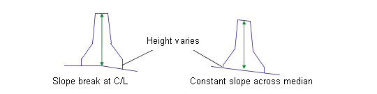

Behavior
The pavement structure links are inserted outward left and right of the attachment point for the given widths and slopes. If the Include Barrier value is True, a New Jersey barrier is inserted symmetrically about the median centerline. If alignments are given as target parameters for the Left and Right Widths, the widths are adjusted to tie to the alignment offsets at each station along the corridor.
If the median is in superelevation with a single constant slope across the entire median, the top of the barrier is slanted to match the median slope. Otherwise the top of the barrier remains horizontal. In all cases, the barrier height (Dimension A) is held constant at the centerline of the barrier.
