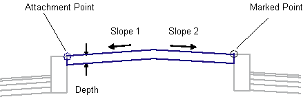

This subassembly inserts links for a constant-slope raised median between two points.
Use the MarkPoint subassembly first if the connecting point has not already been marked.
The attachment point may be at either edge of the median finished grade. The marked point must be at the opposite edge.

Depth |
Depth of the median cap. May be zero for an unpaved median. |
Numeric, positive |
0.100 m 0.333 ft |

Behavior
The median crown point is calculated by intersecting lines extended between the attachment point and the marked point at the given slopes. If no intersection is found, the median is not inserted. If a non-zero Depth is given, the bottom of the median links are inserted parallel to the top, and vertical links are added to close the shape.
Superelevation Axis of Rotation Support
This subassembly works with all axis of rotation pivot methods.
This subassembly produces a raised crown. Even when it is used in a divided crown roadway, the center of the median will be higher than the median edges.
