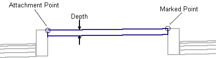

This subassembly inserts links for a constant-slope raised median between two points.
Use the MarkPoint subassembly first if the connecting point has not already been marked.
The attachment point may be at either edge of the median finished grade. The marked point must be at the opposite edge.

Marked Point |
Name of the marked point on the median edge opposite the attachment point |
String |
None |
Depth |
Depth of the median cap. May be zero for an unpaved median |
Numeric, positive |
0.100 m 0.333 ft |

The top of median link is inserted between the attachment point and marked point. If a non-zero Depth is given, the bottom of median link is inserted parallel to the top, and vertical links are added to close the shape.

P1, P2 |
None |
Edges of median on finish grade |
P3, P4 |
L1 |
Top |
Top of median |
L2 |
Datum |
Bottom of median |
L3, L4 |
None |
S1 |
Median |
