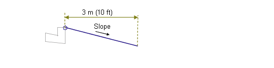

This subassembly is a general purpose utility to extend a link at a given slope until it reaches a defined elevation or profile.
The attachment point is at the inside edge of the link. This subassembly can be inserted in the left or right direction from the attachment point.
