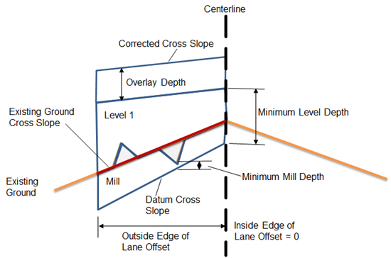

Behavior
- Areas must be provided for all layers.
- The Leveling area is equal to the areas of Level 1 + Mill layers combined.
- The Milling Area layer is represented in the diagram below as Mill.
- Minimum Level Depth is equal to the area from the bottom of the milling layer to the bottom of the overlay layer.

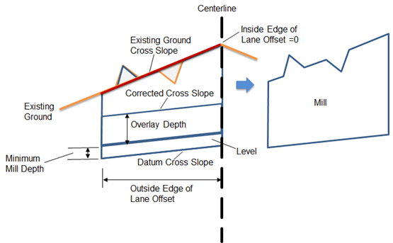

Special Case
The following is an example when Use Profile is selected in Profile Options and the overlay is located below the existing ground.
- The Minimum Mill Depth is measured down from the bottom of Overlay to the Datum layer.
- The area of Minimum Mill Depth will be filled as Level area.
- Total Mill area is from the Datum layer to the Existing Ground layer.
Point, Link and Shape Codes
| Point, Link or Shape | Code | Description |
| P1, P2 | EOV | Overlay edges on finished grade (edges of top of overlay) |
| P3, P4 | EOV_Overlay | Overlay edges beneath leveling layer (edges of bottom of overlay) |
| P7, P8 | EOV_Milling | Overlay edges beneath milling layer (edges of bottom of mill) |
| L1 | Top, Pave | Top of overlay |
| L2, L3, L4 | Overlay | Overlay links |
| L5, L6 | Level | For the leveling case |
| L7, L8 | Mill | For the milling case |
| L9 | Level, Mill, Datum | Links for the milling layer |
| S1 | Overlay | Area between the top and bottom of overlay. This area overlaps the leveling area as shown in the coding diagram below |
| S2 | Level | Area above existing surface and below the bottom of overlay (leveling case) |
| S3 | Mill | Area between bottom of existing surface and bottom of mill (milling case) |
