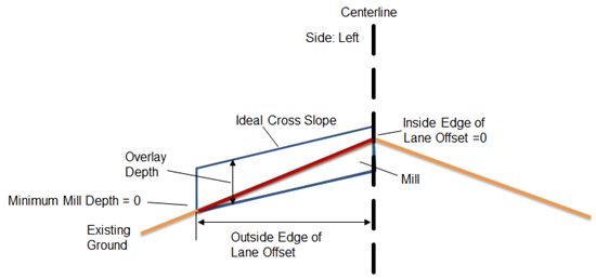

This subassembly overlays one side of an existing road, with a milling layer added as required.
The attachment point is the inside edge point of the overlay layer with finished grade cross slope.

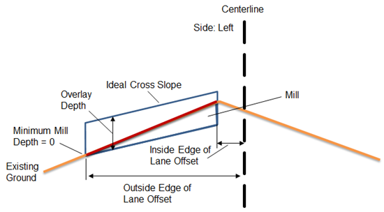

| Inside Edge of Existing Lane | This is the start point for calculating existing ground slope. | Numeric | 0.000m |
| Outside Edge of Existing Lane | This is the end point for calculating existing ground slope. | Numeric | 0.000m |
| Overlay Depth | Depth of the overlay layer. | Numeric | 0.300m |
| Overlay Slope Options | Specifies overlay slope options.
Tip: Flapping is a term used to describe how the corrected cross slope for an overlay in a rehab subassembly is calculated. Flapping outcomes are different, relative to the slope tolerance and the slope difference between existing ground cross slope and ideal cross slope. If the slope difference is less than the slope tolerance for the subassembly, then the use case is considered "within tolerance". If the slope difference is greater than the slope tolerance for the subassembly, then the use case is considered "outside of tolerance."
Note: Slope tolerance is an absolute value. Therefore, for either a slope difference of 0.4% or -0.4%, both have an absolute value of 0.4%. If the slope tolerance is 0.5%, the 0.4% absolute slope difference would be considered within tolerance.
User Defined | User Defined Without Flapping |
| Ideal Cross Slope | Specifies user defined ideal cross slope. | Numeric | -2.00% |
| Lane Width | The lane width, determined by the offset of the outside edge of lane from the inside edge of lane. | Numeric | 12.000m |

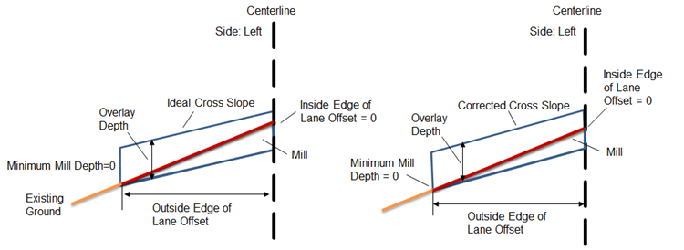

| Use Profile Options | Select to tie the inside edge of overlay to a profile, adjust elevation to minimum level depth, or lock to previous subassembly.
User Defined | Minimum Mill Depth |

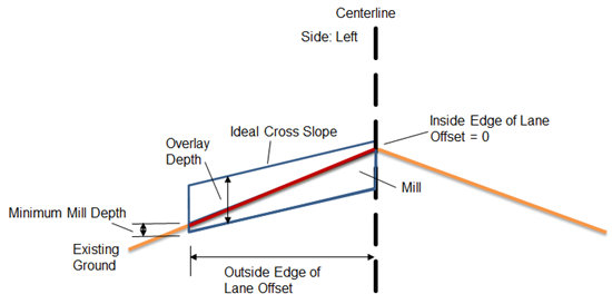

| Minimum Mill Depth | The minimum mill depth between the bottom of the milling layer to the bottom of the existing ground layer. | Numeric | 0.300m |
| Slope Tolerance | Tolerance for varying the overlay slope. | Numeric | 0.50% |

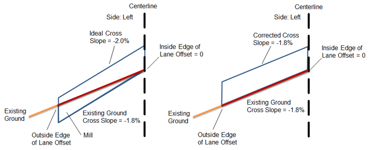

Behavior
This subassembly assumes that no leveling layer is added.

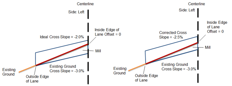

| Existing Ground Cross Slope | -3.0% |
| Existing Ground Cross Slope - Ideal Cross Slope | 1.0% |
| Slope Tolerance | Existing Ground Slope minus Ideal Cross Slope is 1%, which is greater than the 0.5% Slope Tolerance |
| Corrected Cross Slope | The Corrected Cross Slope will be -2.5% |
| Output | Value |
| Corrected Cross Slope | -2.5% |
| Inputs | |
| Ideal Cross Slope | -2.0% |
| Minimum Mill Depth | 0 |
| Slope Tolerance | 0.50% |
| Overlay Slope Options | User Defined With Flapping |
| Use Profile Options | Minimum Mill Depth |
| Input | Value |

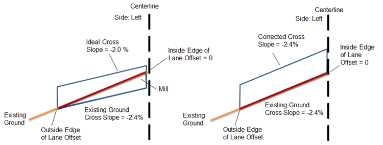

| Existing Ground Cross Slope | -2.4% |
| Existing Ground Cross Slope - Ideal Cross Slope | -0.4% |
| Slope Tolerance | Existing Ground Slope minus Ideal Cross Slope is 0.4%, which is less than the 0.5% Slope Tolerance. |
| Corrected Cross Slope | The Corrected Cross Slope will be -2.4% |
| Output | Value |
| Corrected Cross Slope | -2.4% |
| Inputs | |
| Input | Value |
| Existing Ground Cross Slope | -1.8% |
| Existing Ground Cross Slope - Ideal Cross Slope | 0.2% |
| Slope Tolerance | Existing Ground Slope minus Ideal Cross Slope is 0.2%, which is less than the 0.5% Slope Tolerance |
| Corrected Cross Slope | The Corrected Cross Slope will be -1.8% |
| Output | Value |
| Corrected Cross Slope | -1.8% |

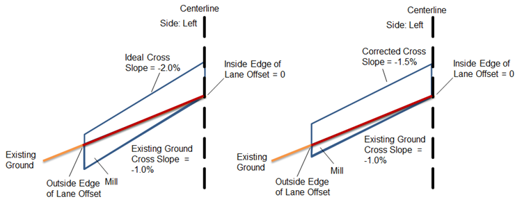

| Existing Ground Cross Slope | -1.0% |
| Existing Ground Cross Slope - Ideal Cross Slope | 1% |
| Corrected Cross Slope | The Corrected Cross Slope will be -1.5% |
| Output | Value |
| Corrected Cross Slope | -1.5% |
