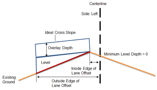

This subassembly overlays one side of an existing roadway, with a leveling layer added as required.
The attachment point is the inside edge point of the overlay layer with finished grade cross slope.

Ideal Cross Slope Specifies user-defined ideal cross slope. Numeric -2.00%
Lane Width The lane width, determined by the offset of the outside edge of lane from the inside edge of lane. Numeric 0.000m (0.000 ft)
Use Profile Options Select to tie the inside edge of the overlay layer to a profile, adjust elevation to minimum level depth, or lock to previous subassembly.

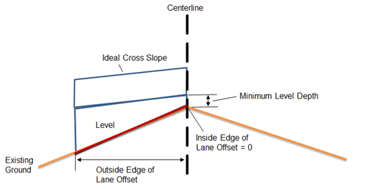

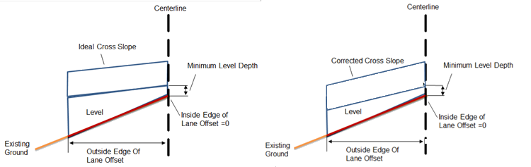

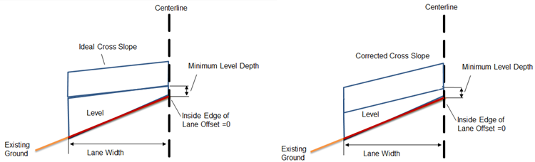

  • Minimum Level Depth
    The cross slope and elevation adjustments will meet Minimum Level and/or Minimum Mill Depth. The base is the existing surface.
  • Use Profile
    There will be no elevation adjustment. The elevation of the rehab subassembly attachment point will match the assigned profile. The cross slope adjustment will be determined by Overlay Slope Options.
  • Lock to Previous
    There will be no elevation adjustment. The elevation of the rehab subassembly attachment point will match the attachment point of the previous subassembly (in most cases this will be the previous lane's end point). The cross slope adjustment will be determined by Overlay Slope Options.
User defined Minimum Level Depth
Minimum Level Depth The minimum level depth between the existing surface and the bottom of the overlay layer. Numeric 0.300m (0.300 ft)
Slope Tolerance The amount that the overlay cross slope is allowed to vary from the existing ground cross slope or the ideal cross slope. Numeric, positive 0.50%

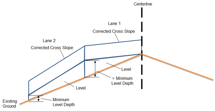

Inside Edge of Lane Offset

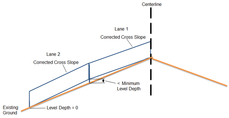

Lock to Previous 1
In this use case the second lane is set to use the Lock to Previous option. The attachment point for Lane 2 will lock to the elevation of the end of Lane 1. The level depth at the start of the second lane is greater than the minimum level depth specified for that lane.
The corrected cross slope will be calculated and applied, but no elevation adjustment or flapping will be applied. In some cases, the minimum level depth might not be met.
Lock to Previous 2
In this use case the second lane is set to use the Lock to Previous option. The attachment point for Lane 2 will lock to the subassembly of Lane 1. The level depth at the start of the second lane is less than minimum level depth specified for that lane.
Minimum Level Depth

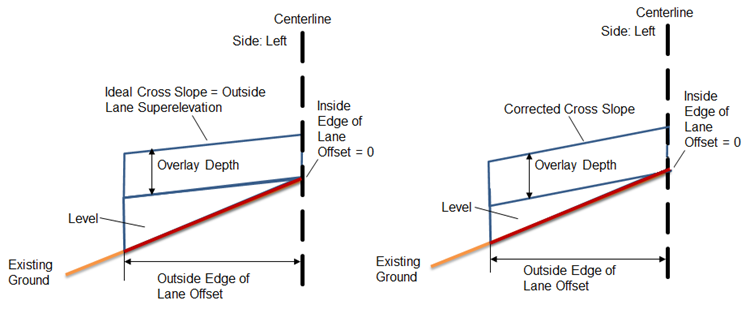

Outside Lane Superelevation
The ideal cross slope is equal to the outside lane superelevation.
Note: A superelevation table for the alignment is required to read these values. Superelevation values will be read from the superelevation table for the alignment.

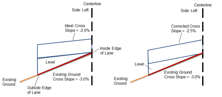

Case 1-1: Ideal Cross Slope is greater than Existing Ground Cross Slope
Inputs:
Inputs
Ideal Cross Slope -2.0%
Minimum Level Depth 0
Slope Tolerance 0.50%
Overlay Slope Options User Defined With Flapping
Use Profile Options Minimum Level Depth
Inside Edge of Lane Offset true (values vary)
Outside Edge of Lane Offset true (values vary)
Calculations:
Input Value
Existing Ground Cross Slope -3.0%
Existing Ground Cross Slope - Ideal Cross Slope -1.0%
Slope Tolerance Existing Ground Slope minus Ideal Cross Slope is -1%, which is greater than the 0.5% Slope Tolerance
Corrected Cross Slope The Corrected Cross Slope will be adjusted to -2.5%
Output Value
Corrected Cross Slope -2.5%

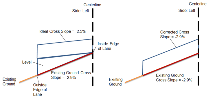

Case 1-2: Ideal Cross Slope is greater than Existing Ground Cross Slope
Inputs:
Inputs
Ideal Cross Slope -2.5%
Overlay Slope Options User Defined with Flapping
Calculations:
Input Value
Existing Ground Cross Slope -2.9%
Existing Ground Cross Slope - Ideal Cross Slope -0.4%
Slope Tolerance Existing Ground Slope minus Ideal Cross Slope is -0.4%, which is less than the 0.5% Slope Tolerance.
Corrected Cross Slope The Corrected Cross Slope will be -2.9%
Output Value
Corrected Cross Slope -2.9%

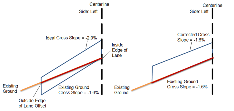

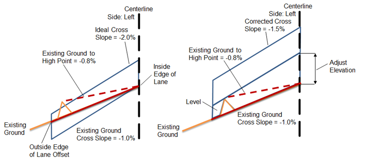

Case 1-3: Ideal Cross Slope is less than Existing Ground Cross Slope
Inputs:
Inputs
Calculations:
Input Value
Existing Ground Cross Slope -1.6%
Corrected Cross Slope The Corrected Cross Slope will be -1.6%
Output Value
Corrected Cross Slope -1.6%

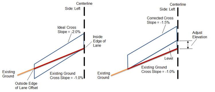

Case 1-4: Ideal Cross Slope is less than Existing Ground Cross Slope
Inputs:
Inputs
Calculations:
Input Value
Existing Ground Cross Slope -1.0%
Slope Tolerance Existing Ground Slope minus Ideal Cross Slope is -1.0%, which is greater than the 0.5% Slope Tolerance
Corrected Cross Slope The Corrected Cross Slope will be -1.5%
Output Value
Corrected Cross Slope -1.5%

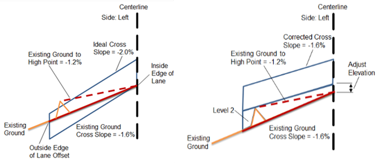

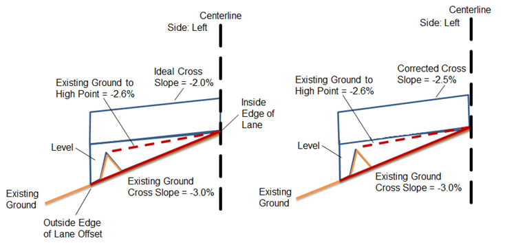

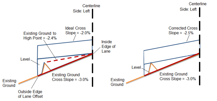

Case 2-1: Ideal Cross Slope is greater than High Point
Inputs:
Inputs
Calculations:
Input Value
Existing Ground Cross Slope - Ideal Cross Slope 1.0%
High Point Cross Slope, measured from Inside Edge of Lane to High Point -2.6%
High Point Cross Slope - Ideal Cross Slope -0.6%
Slope Tolerance The Slope Difference between the Existing Ground Cross Slope minus Ideal Cross Slope result is 1.0%, which is less than the Slope Tolerance of 0.50%
Corrected Cross Slope The Corrected Cross Slope will be -2.5%
Output Value
Case 2-2: Ideal Cross Slope is greater than High Point
Inputs:
Inputs
Calculations:
Input Value
High Point Cross Slope, measured from Inside Edge of Lane to High Point -2.4%
High Point Cross Slope - Ideal Cross Slope -0.4%
Slope Tolerance Existing Ground Cross Slope minus Ideal Cross Slope is 1.0%, which is greater than the 0.5% Slope Tolerance
Output Value
Case 2-3: Ideal Cross Slope is less than High Point
Inputs:
Inputs
Calculations:
Input Value
Existing Ground Cross Slope - Ideal Cross Slope 0.4%
High Point Cross Slope, measured from Inside Edge of Lane to High Point -1.2%
High Point Cross Slope - Ideal Cross Slope -0.8%
Slope Tolerance Existing Ground Cross Slope minus Ideal Cross Slope is 0.4%, which is less than the 0.5% Slope Tolerance.
Output Value
Case 2-4: Ideal Cross Slope is less than High Point
Inputs:
Inputs
Calculations:
Input Value
High Point Cross Slope, measured from Inside Edge of Lane to High Point -0.8%
High Point Cross Slope - Ideal Cross Slope -1.2%
Slope Tolerance Existing Ground Cross Slope minus Ideal Cross Slope is 1.0%, which is greater than the 0.5% Slope Tolerance.
Output Value

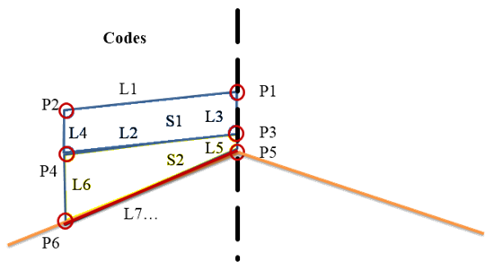

Point, Link, and Shape Codes.
The following table lists the point, link, and shape codes for this subassembly that have codes assigned to them. Point, link, or shape codes for this subassembly that do not have codes assigned are not included in this table.
Point, Link, or Shape Code Description
P1, P2 EOV Overlay edges on finish grade
P3, P4 EOV_Overlay Edges of bottom of overlay
P5, P6 EOV_Leveling Edges of bottom of level
L1 Top, Pave Top of overlay
L2, L3, L4 Overlay Overlay links
L5, L6 Level For the leveling case
S1 Overlay Area between the top and bottom of overlay
S2 Level Area between the top and bottom of level
L7 Existing Ground Cross slope of the existing ground
Coding Diagram
