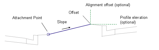

This subassembly is a general purpose utility to connect a link from the attachment point to a specified offset at a given slope.
An alignment can be substituted for the offset, and a profile for the slope.
The attachment point is at the beginning of the link. The direction of the link is determined by the location of the given offset and slope.

A link is added from the attachment point to the given offset at the given slope.
This subassembly includes an optional input parameter named Use Superelevation Slope that lets you specify to use the superelevation slope for the shoulder. This parameter can be set to a) Outside shoulder slope, b) Inside shoulder slope, c)Outside Lane, d)Inside Lane, or e) None. None is the default setting.
If the input offset value is a negative number and superelevation slope is specified (Use Superelevation Slope parameter not set to None), the values from the left side lane or shoulder will be used. If a positive offset is specified, the values from the right side superelevation will be used.
