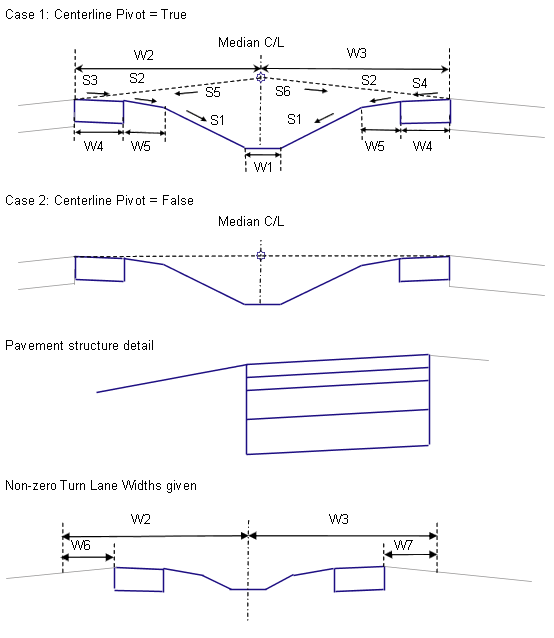

This subassembly creates a cross-sectional representation of a depressed median with inside shoulders, using vertical termination of shoulder subbase.
It supports superelevation pivoting about the attachment point at the centerline, or about the attachment point elevation at the inside edges-of-traveled-way. The pavement structure on the paved portions of the shoulder follows the standards described in "Pavement Structure of Paved Sections" in the Autodesk Civil 3D Help.
| Table of Widths | Table of Slopes | ||
W1 |
Ditch |
S1 |
Ditch of Foreslope |
W2 |
Left Median |
S2 |
Unpaved Shoulder Slope |
W3 |
Right Median |
S3 |
Left Inside Superelevation |
W4 |
Paved Shoulder |
S4 |
Right Inside Superelevation Shoulder Slope |
W5 |
Unpaved Shoulder |
S5 |
Left Outside Lane Slope |
W6 |
Left Turn Lane |
S6 |
Right Outside Lane Slope |
W7 |
Right Turn Lane |
The attachment point is above the centerline of the ditch. The location of the median links relative to the attachment point varies depending on the pivot method, and in some cases, the median widths and lane slopes. The attachment point is typically placed on the baseline alignment at the design profile elevation.

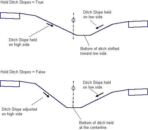

Hold Ditch Slopes |
For the cases where the top-of-ditch-slope points are at unequal elevations, selects whether to hold the ditch sideslopes and let the position of the ditch shift, or to hold the ditch at the center and adjust the sideslope on the high side. |
Selection list |
Hold ditch sideslopes, shift ditch from center |

This subassembly cannot be inserted separately for the left and right sides. It builds the median to both sides of the attachment point.
Superelevation Pivot Point
The median can be configured to have the superelevation pivot point at the centerline, or at the inside edges of traveled ways. If Centerline Pivot is used, the left and right outside lane superelevation slopes are obtained from the baseline’s superelevation specifications, and the elevations of the inside edges-of-traveled-ways are calculated by applying these slopes to the left and right median widths from the attachment point. If Centerline Pivot is not used, the edges-of-traveled-ways are held to the elevation of the attachment point.
Ditch Elevations and Slopes
Superelevation or turning lanes may cause the top of the ditch slopes to be at different elevations on the left and right sides, resulting in an asymetrical ditch. There are two options for handling this situation. If Hold Ditch Slopes is set to True, then the given ditch slopes are held constant on both sides, which shifts the bottom of ditch away from the centerline towards the lower side. If set to False, the ditch bottom is centered about the median centerline, the given slope is held on the lower side, and the slope is adjusted to match on the higher side.
Shoulder Treatment
The paved portions of the shoulders follow the slopes defined for the left and right inside shoulder slopes for the baseline alignment’s superelevation specifications. These slopes are applied inward from the inside edges of traveled ways. The unpaved portions of the shoulders are fixed at the given Unpaved Shoulder %Slope value.
Superelevation Axis of Rotation Support
This subassembly works only with Roadway Types that have a Pivot Method of Median Edges and a Median Treatment of Maintain Median Shape. If you use this subassembly with any other Pivot Method or with Distorted Median Treatment, it will produce a result equivalent to Median Edges with Maintain Median Shape.
Layout Mode Operation
In layout mode, this subassembly calculates and displays the median and shoulders based on the input parameters given, and assuming that the lane slopes are -2% and the paved shoulder slopes are -5%.
