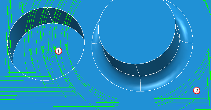

Remove segments smaller than threshold — Select this option to remove segments that are smaller than the Threshold value.
Remove segments smaller than threshold option deselected:
Remove segments smaller than threshold selected:
Removes the small segments in areas and .
Note: If segments are smaller than the threshold value but surround a boss they are not removed.

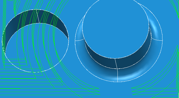

Threshold (tool diameter units) — Enter the size against which all segments are compared. The higher the threshold value, the more segments are removed.
— Segment length (Ls)
— Pocket length (Lp)
— Tool diameter (D)
— Non-cutting tool diameter (d)
This example uses a constant Z toolpath.
Threshold (tool diameter units) 1.5:
Threshold (tool diameter units)0.7:
To calculate the minimum threshold value, divide the non-cutting diameter by the full tool diameter. Values smaller than this do not remove all unsafe segments.
Note: A value of 1 always removes all unsafe segments, but may also remove some safe segments.

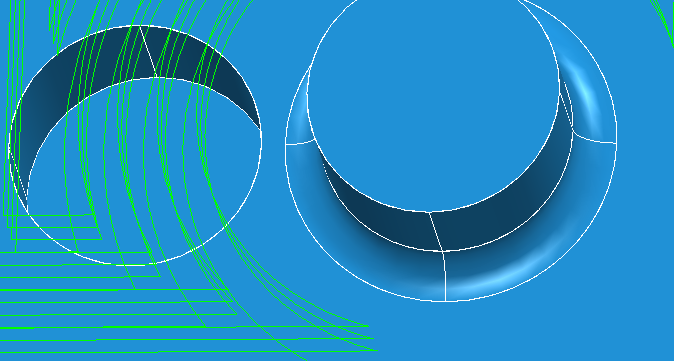

Only remove segments from enclosed areas — Select this option to remove segments, in enclosed areas, that are smaller than the Threshold value.
Remove segments smaller than threshold and Only remove segments from enclosed areas deselected:
Remove segments smaller than threshold and Only remove segments from enclosed areas selected:
Removes the small segments in area , but doesn't remove the segments in area .
