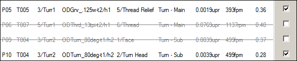

— Click to display options for the Status column in the Process Table. When the Status option is selected for a process, PartMaker includes the process in simulation and postprocessing.
  • Show Process Status/Hide Process Status — Select to show or hide the Status column in the Process Table.
  • Enable All Processes — Select to enable the Status option for all processes.
  • Disable All Processes — Select to disable the Status option for all processes.

Status — When the Status option is selected for a process, PartMaker includes the process in simulation and in postprocessing.
You can select or deselect individual processes by clicking the Status check box for that process.
To enable or disable the Status option for all processes in the table, click on the Process Table toolbar:
  • Select Enable All Processes to select the Status option for all processes in the table.
  • Select Disable All Processes to de-select the Status option for all processes in the table.
PartMaker uses a strikethrough to denote processes that are excluded from simulation and postprocessing. For example:
Tip: The Status column is displayed only if the Job Optimizer > Show Process Status menu option is selected.
