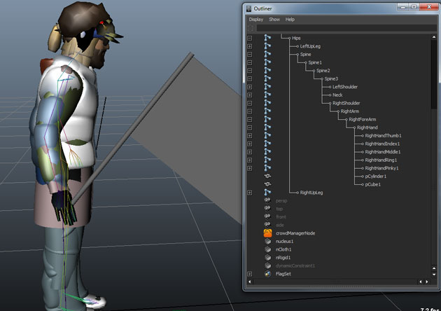

- create a flag, and parent it (with its pole) to the hand bone.

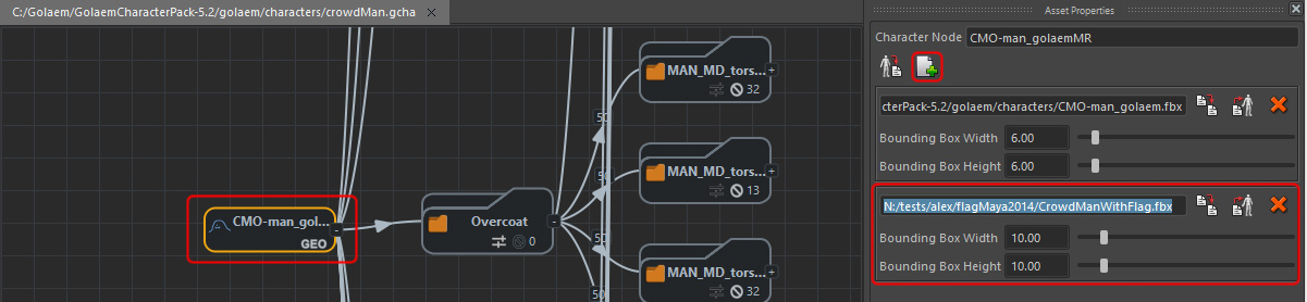

- Open the Character Maker, load the Character File (.gcha) and go to the Geometry Tab
- Select the Character Node in
main workspace, and relocate its Geometry File in the Asset Properties panel by clicking on
the
button. Browse to the geometry file
you just exported with the flag. You may need to set a bigger bounding
box than the usual character because of the flag simulation.

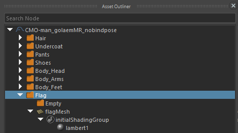

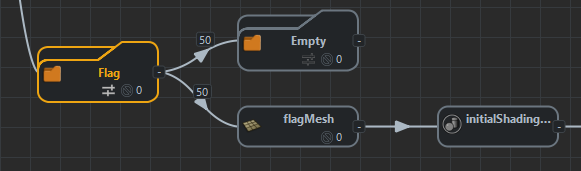

- Create a new Asset Group node named Flag and connect it to the Character Node
- Add an new Asset Group node named Empty and connect it to the Flag Asset Group node. This will let you have part of the characters without flags

will add a flag Mesh Asset node in the Flag Asset Group node - Set the Flag Asset Group node as weighted by clicking on
the
button on the node (or
by checking the Weighted checkbox in the Asset Properties panel)

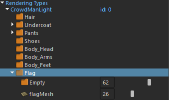

- Then in the Rendering Types view, adjust the weights of the Flag group.

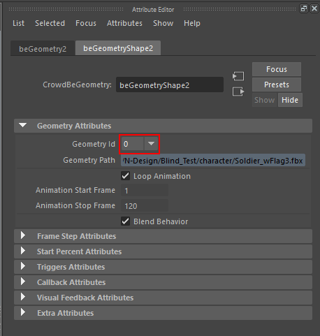

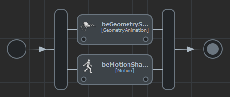

- Open the Behavior Editor, and add a Geometry Behavior (it should be added in a Parallel Operator if the character should also play a motion at the same time).
- Go inside the geometry Behavior attributes and set the geometry Id so the fbx/gcg is found inside your gcha.
- Finally, set a correct start/stop frame to play the animation.

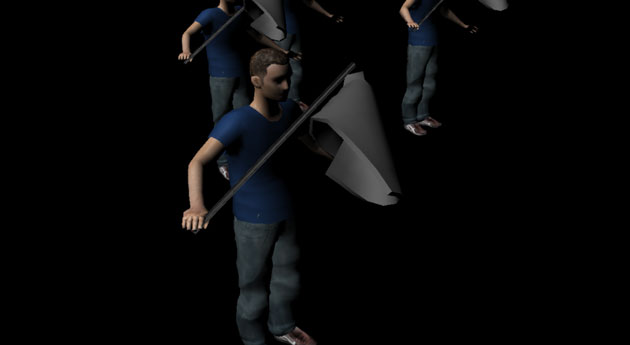

You are now ready to run the simulation tool and render your animation!
